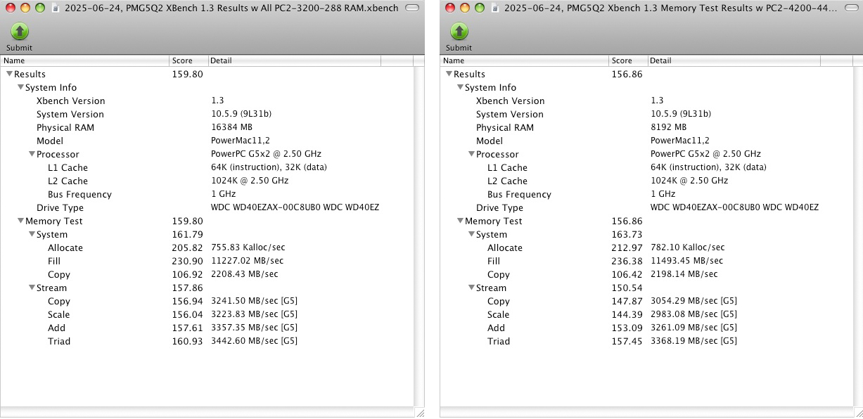

I have always wondered whether equipping your Power Mac G5 Quad with PC2-4200U-444 RAM would make for a faster machine than if the same machine were equipped with PC2-3200U-288 RAM. It seems obvious that the faster RAM ought to make for a faster machine, but as we shall see in a moment, it doesn't really make a whole lot of difference!
Since I have just resurrected my LCS-cooled Quad, which has been sporting 8 GB of PC2-4200U-444 RAM up until now, and I have been totally unsuccessful selling the 16 GB of PC2-3200U-288 RAM that came with it originally, I sensed an opportunity to finally answer this question.
So, using XBench 1.3's Memory test, I tested first with the PC2-4200U RAM and then swapped out that RAM for the PC2-3200U RAM and tested again. The results are presented below, side by side, with the PC2-3200U results on the left and the PC2-4200U results on the right:
As you can see, the results are virtually identical within a small tolerance. Some things are faster with the 3200U RAM and some are faster with the 4200U RAM, but the bulk are more or less the same.
So, worried about the RAM that came with your machine? Should you upgrade PC2-3200U RAM to PC2-4200U RAM to get more speed? My advise would be not to bother... it does not seem to make much difference.
This is with XBench 1.3. Are there any known weaknesses of this test suite that might skew these results?

According to manual Quad has 533 MHz memory controller, so fastest continuous data stream has PC-4200 ( 533 MHz) modules.
Bigger speed of lower-frequency modules is caused by different CAS latency.
Btw, what is PC2-3200U-288 ? Is it CAS latency or something else?
If it is, it probably should be -222-8 in more standard way, where 8 is ns. But who knows.
In your example second modules are PC4200-444-12, i.e. 12 ns latency. So if reading from RAM is not continual, it takes 50% more time to read data from new place.
If you are search for speed, I recommend PC2-4200 CL 333 modules. It should be fastest.

If I look to your benchmark pictures, there are also stream results, and PC2-3200U-288 is faster than PC2-4200U-444.
It is strange. Are you sure, that "PC2-3200U-288" is really PC-3200 module? I am suspicious, that you have in real faster module and only OSX Profiler shows this value. If you want, you can look on label and chip types on memory module.
In any case, most important are real world results, so if PC2-3200 gives you better results than PC2-4200, keep it.
