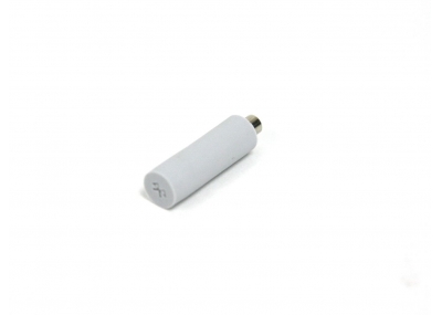

first things first , is the AirPort Extreme connected with 2 small wire to the Antenna ports at the back ot the G5 ? one port is for the WIFI antenna the other for the bluetooth antenna
here how the antennas looks like
airport antenna
250
(and sometimes it helps up to 3 more bars if you rotate the antenna a bit)
bluetooth antenna
and no antennas at the back means weak signal if you are lucky to get one at all
mine shows without the antennas a extremely weak wifi signal and it will change form about 2 bars to 4 bars if i rotate the antenna , but i prefer ethernet as i am not a huge fan of anything wireless
If you have the dual processor powermacs you should have the antennas in order for the wifi and bt to work...
