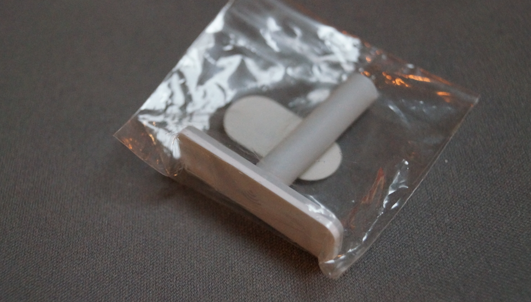

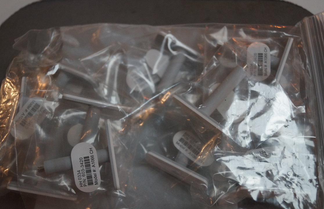

Send me a PM with your address. I'll send you one in a first class envelope. Sometimes being a Mac hoarder helps.
