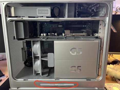

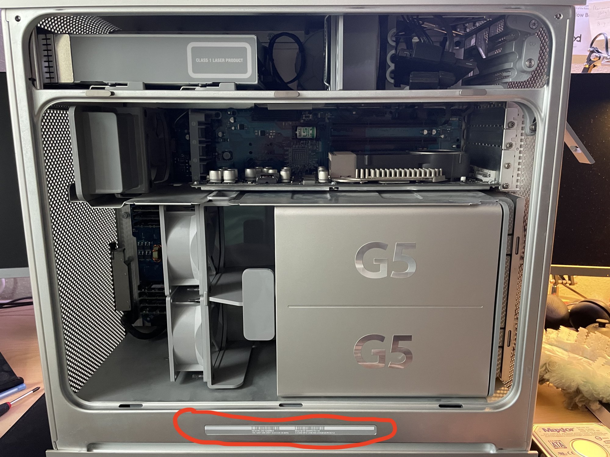

You can check the specs of a G5 by opening the side panel and looking over the sticker at the bottom.

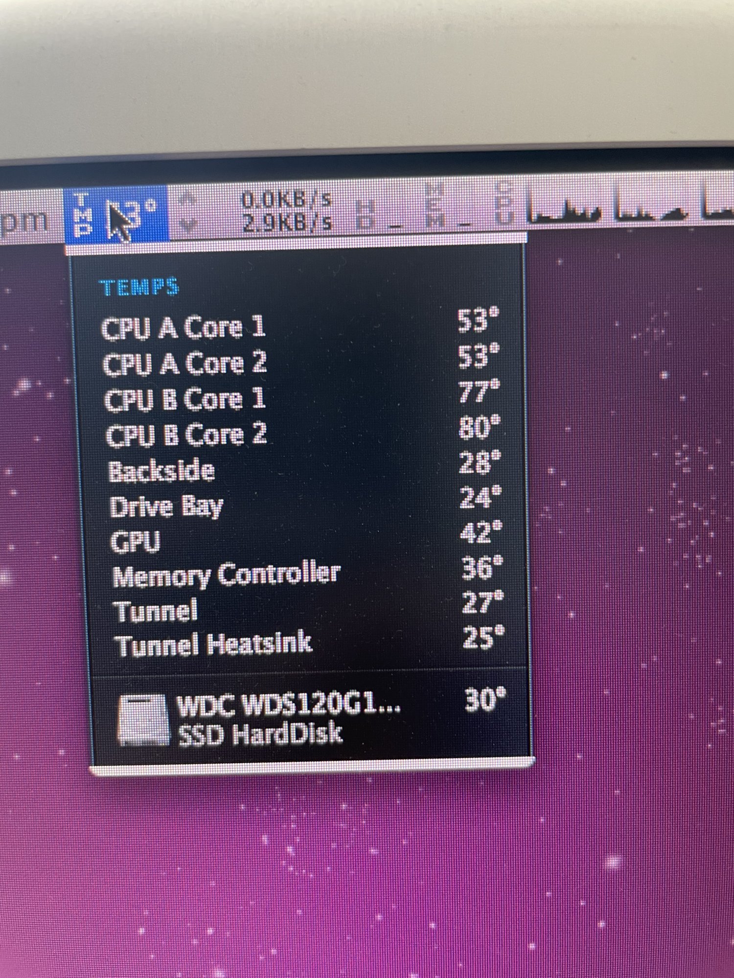

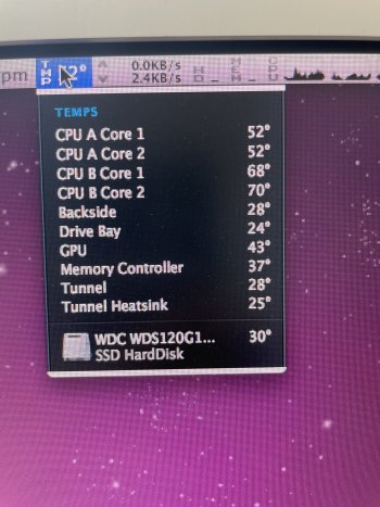

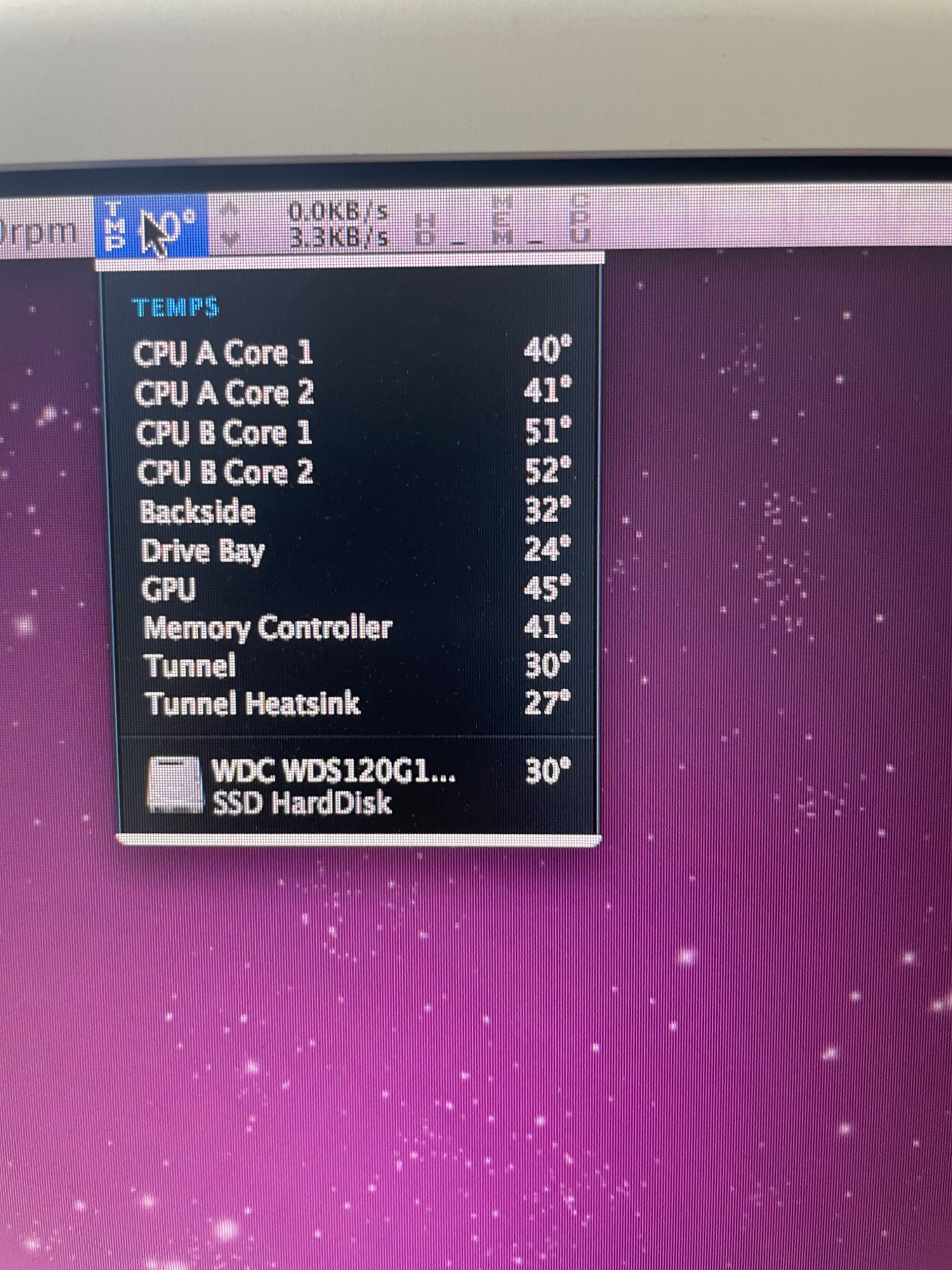

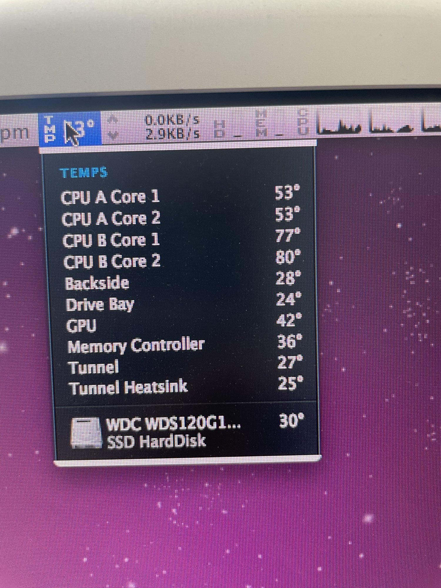

I also have a liquid-cooled G5 Quad and applied the "New-Blood Mod". It boots, but one of the CPUs overheats after a few minutes of normal use. Initially I thought one of the pumps had failed, but after some trouble shooting, determined both pumps are working. The problem seems to be the radiator isn't doing a good job cooling the fluid, so the fluid just gets hotter and hotter as it runs. I think cleaning the radiator in an ultrasonic cleaner would fix it, but am short on cash to buy an ultrasonic cleaner.

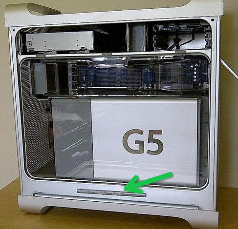

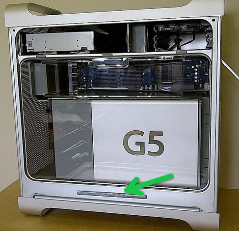

Yes and no. You can't see it from the outside (besides that there are some changes over time with several models on the back). Just ask if they open up the G5 and let them make a picture of the sticker at the bottom. There is the config information of the G5. See picture.

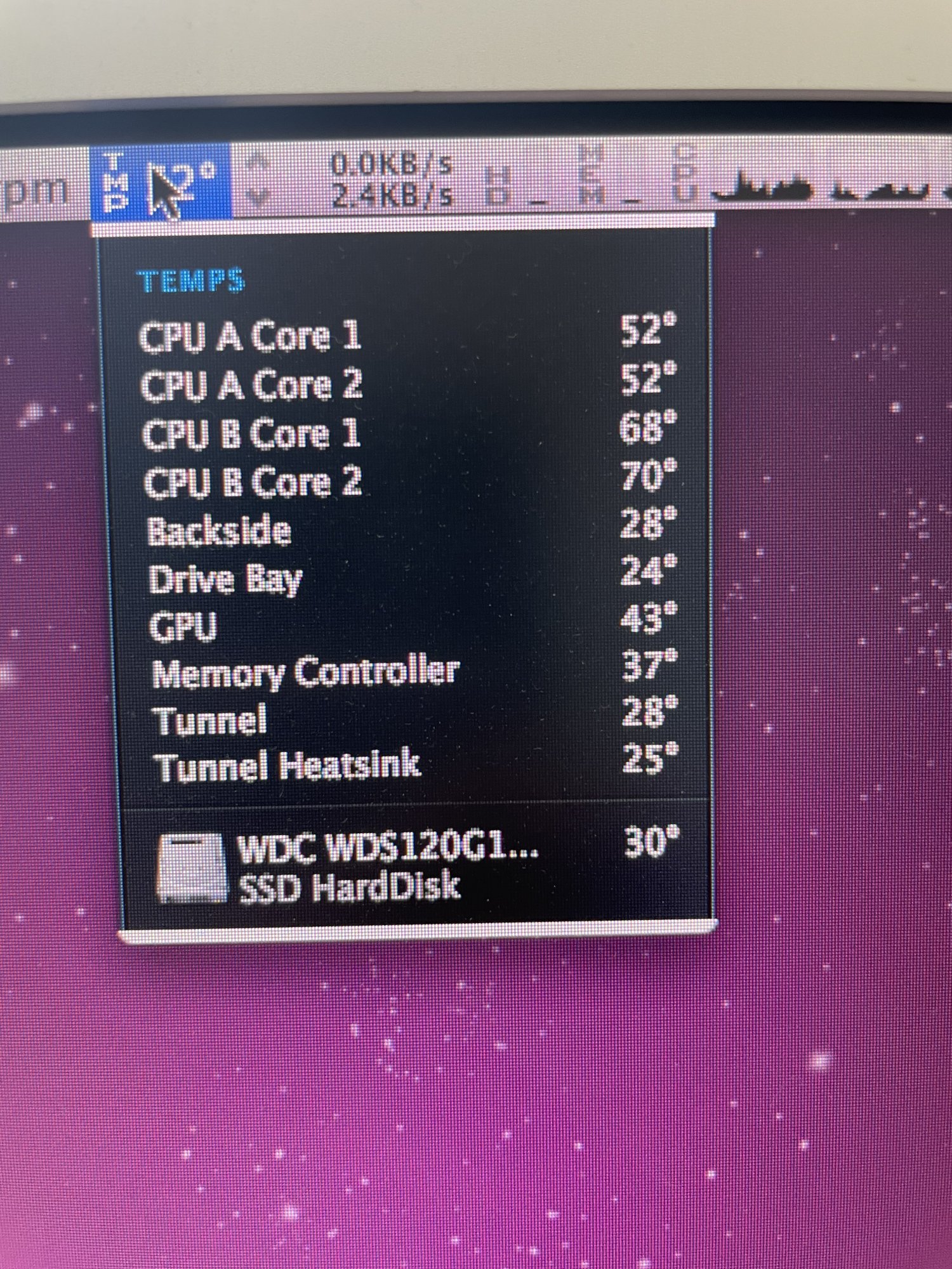

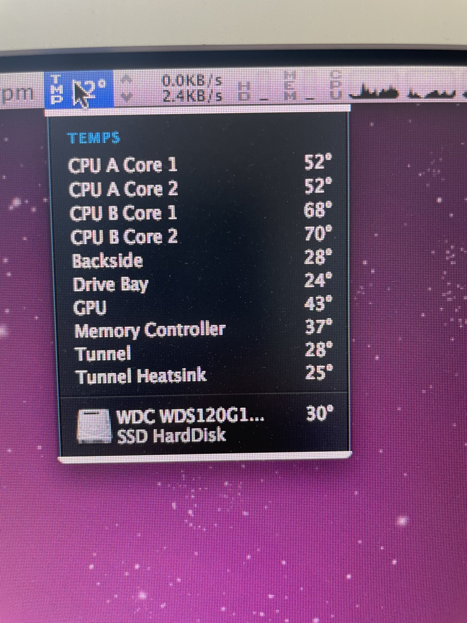

I also own a Quad G5 with the same problem. I think the thermal paste is EOL and I will make it a winter project to clean and fix my Quad G5. Then looking for the ultimate videocard and some RAM to max out. If people like it I can make notes of the progress. I am using Sorbet Leopard.
