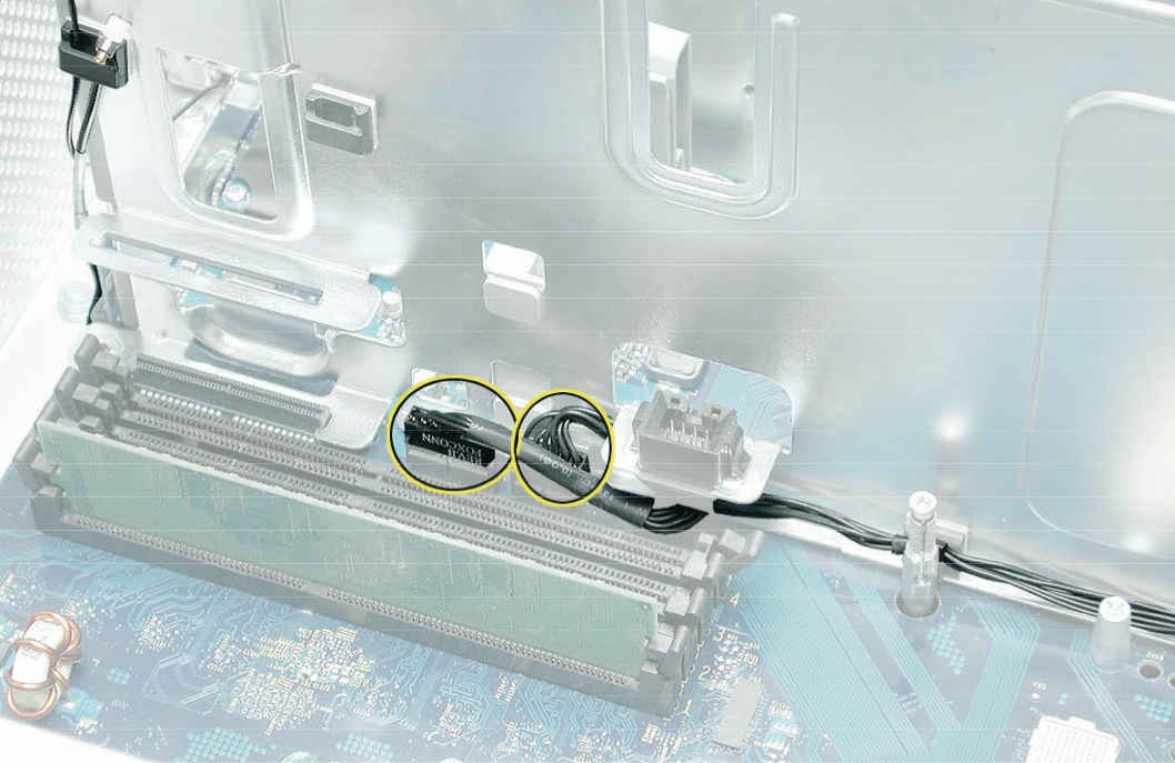

Okay, trying to install the logic board today but I've hit a slight snag; obviously the dual 2.5ghz is liquid cooled, and the dual 2.0ghz model of the same generation was not, and it's a dual 2.0ghz logic board that I've now received as a replacement. This in itself should not be a problem as it just means that the processors will be under-clocked.
However, the power connector for the liquid cooling system is absent from the dual 2.0ghz logic board! Bah!
So now I need a cable to somehow connect power to the liquid cooling. Immediately next to the LCS power connector is a 10-pin connector for the front-fan, the LCS connector is a 6-pin one, I'm wondering if it's possible to get a 10 pin cable that splits off into a 10-pin and a 6-pin connector so I could use the same socket for both?
I'm thinking that that probably wouldn't work though, another possibility is a y-cable from the DVD drive's power connector, into the same connector (so I can still use the DVD drive), and also into a 6-pin (male) connector. The alternative is that I have to try and find a heatsink unit suitable for a G5.
Don't suppose anyone has any ideas here?
I've attached the picture from the G5 technical guide, but it's not a very good picture of the right-hand cable. The cable is completely unmarked so I can't even look up what it is. Interestingly the actual part it connects to in the LCS only has four pins, but it has the gaps where other pins would be.

Have you tested the 2.5 CPUs in the 2.0 logic board? I'm wondering if it's compatible? You can tap into the molex connector on the optical drive for 12v. It would be the yellow wire if you use a splitter. The pump would run full blast all the time...
Only the 2.7 and 2.5 DP G5s were liquid cooled. Ever think of finding some heatsinks off the air-cooled G5s and swapping them onto your 2.5 CPUs and just eliminating the LCS altogether?

I haven't been able to find any heat-sinks so far, except attached to processors and going for fairly silly prices. I don't suppose heat-sinks from elsewhere would work?
