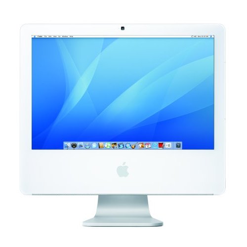

You could get an iMac G5 or one of the early intel model... 🙂
The graphics card on the iMac G5 is not upgradable and it is also considered to be one of the most unreliable Macs ever produced.

May I suggest that you don't buy a powermac if you are just starting out on a mac, as you won't get the "mac experience" from one. how about a nice intel core solo mini or a white intel core 2 duo imac.
Yes I'm just starting out with a mac and I know I won't get the full experience because i'll be using 10.6? but i don't want to spend alot of money to find out I hate it or something
