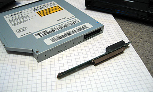

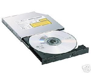

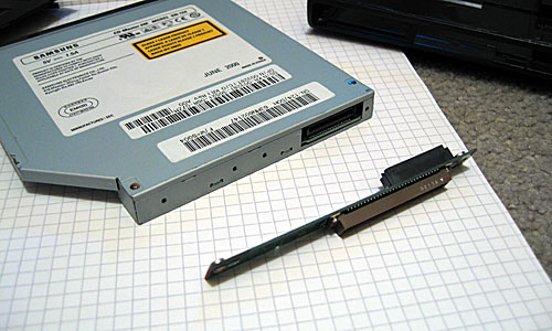

Almost ALL DVD drives have the same general shape, and will fit in most computers, older macs, or pcs. I said older Macs, because the newer 2012 Macbooks have VERY thin superdrives, and might not fit in a standard slot. EDIT: Most drive connectors are removable and can be replaced with a different connector.
See:
Too long
