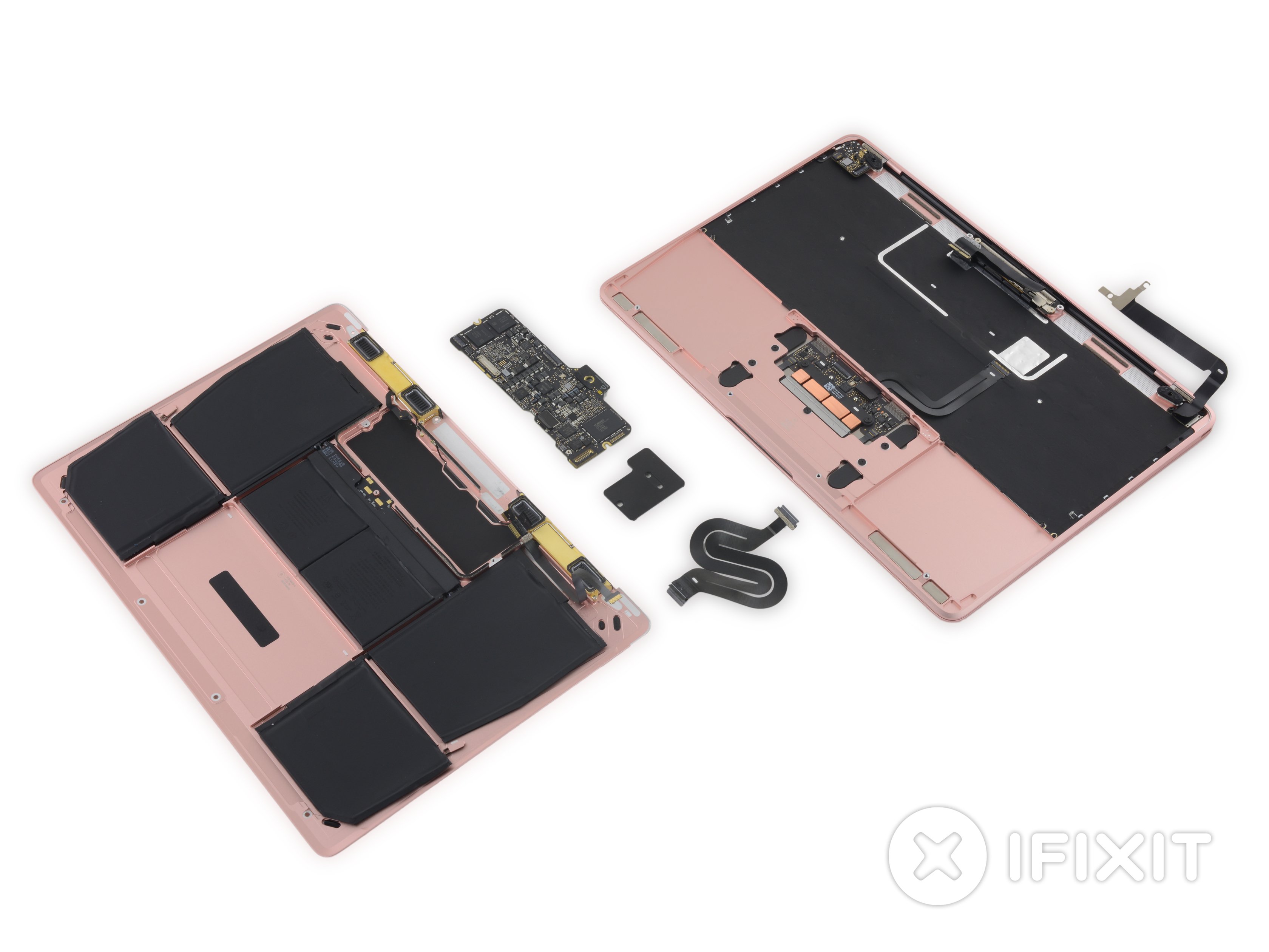

It's out of warranty so if it were me I'd whip the back off and have a good look at it.
The chances of fixing it yourself are almost nil but it's likely there will be telltale signs of whatever has gone 'pop'.
There will likely be charring somewhere. You might see something has splashed, bulged, exploded....
You may even get a clue by smell. It's rare something dies catastrophically like that and leaves no trace.
You've nothing to lose just examining it carefully. Really have a good look.
You can refer to a teardown like this to identify parts:
With a bit of luck you'll have some idea what's happened. It might well just be the power module.
There may even be a fuse on the power side but you won't know until you've had a look. Doesn't look like there is but there might be.
If so it'll give you a better idea of if it's worth sending it into someone for repair.
You might learn nothing of course in which case it'll be half an hour or so of your life lost.
(Make sure you don't lose the screws).
