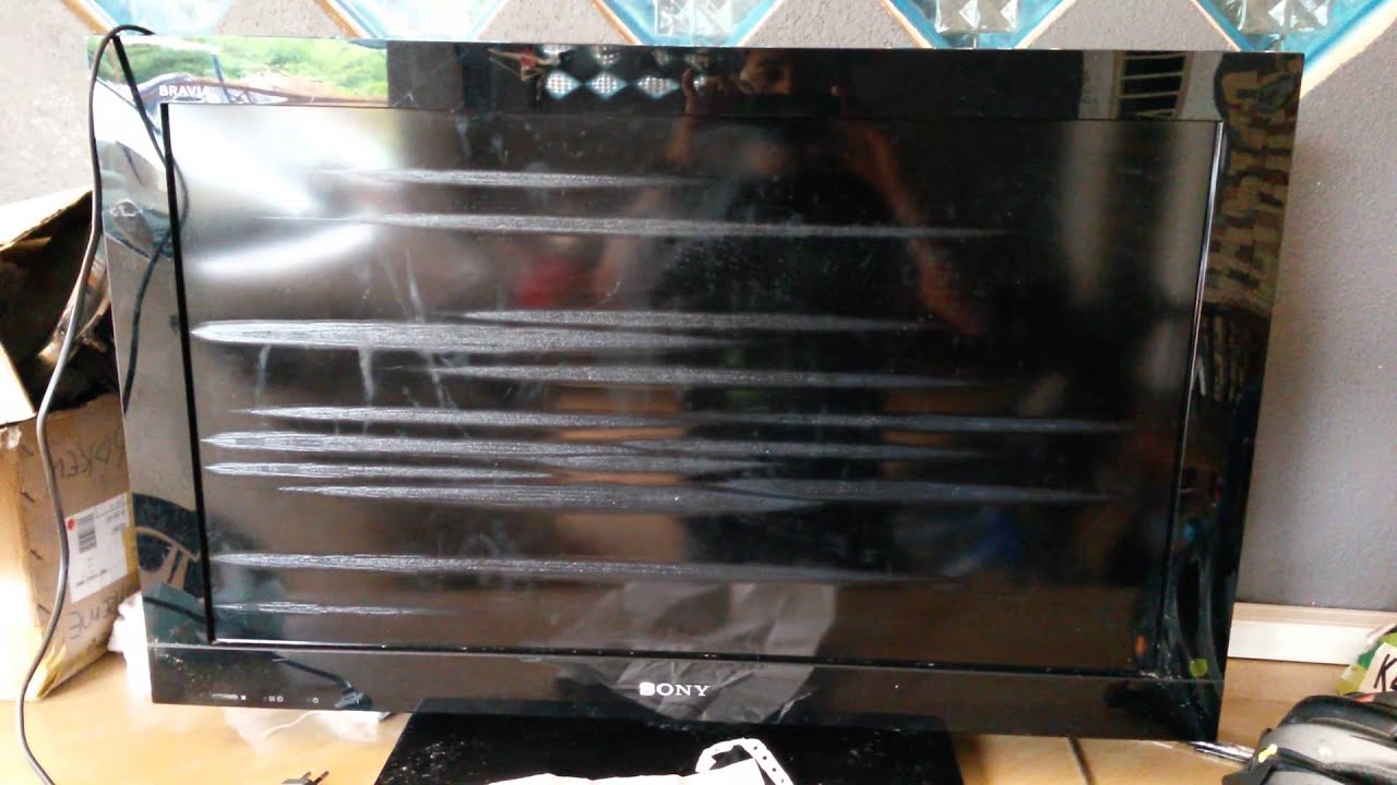

Any notebook you buy over the age of 20 will now be subject to a chronic polarizer problem, it is simply the end of the display's useful life, be it ibook, powerbook, compaq, dell, or any other that has been kept for many years and is over 20 years old.
Something like the image below
You can remove the damaged film and paste a new one (it is a bit of a hassle), or simply change the display.

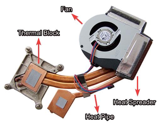

Off the top of my head the problem was that (a) the chip naturally ran hot (b) the cooling system looked something like this, with a combined cooling system for the CPU and GPU:
But the BIOS only monitored the temperature of the CPU, so if you played games or watched HD video the GPU ended up running way hot all the time.
