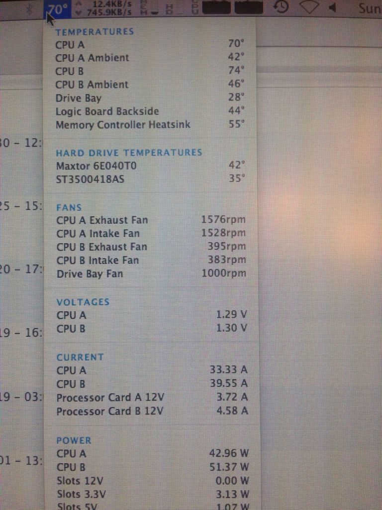

My 17" doesn't see anything higher than 145 as well! My 2.3 G5 hovers around 140-155 with each processor being 1-3 degrees apart whereas my 2.7 is like 15 degrees apart.
A difference is, of course, normal because the LCS pumps hot liquid from one processor to the next before it is cooled.

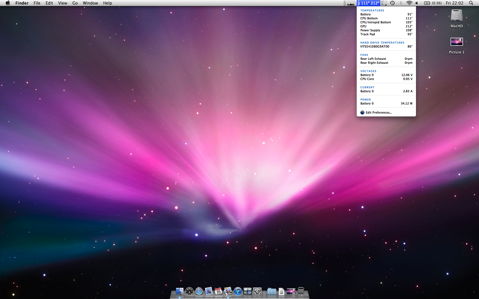

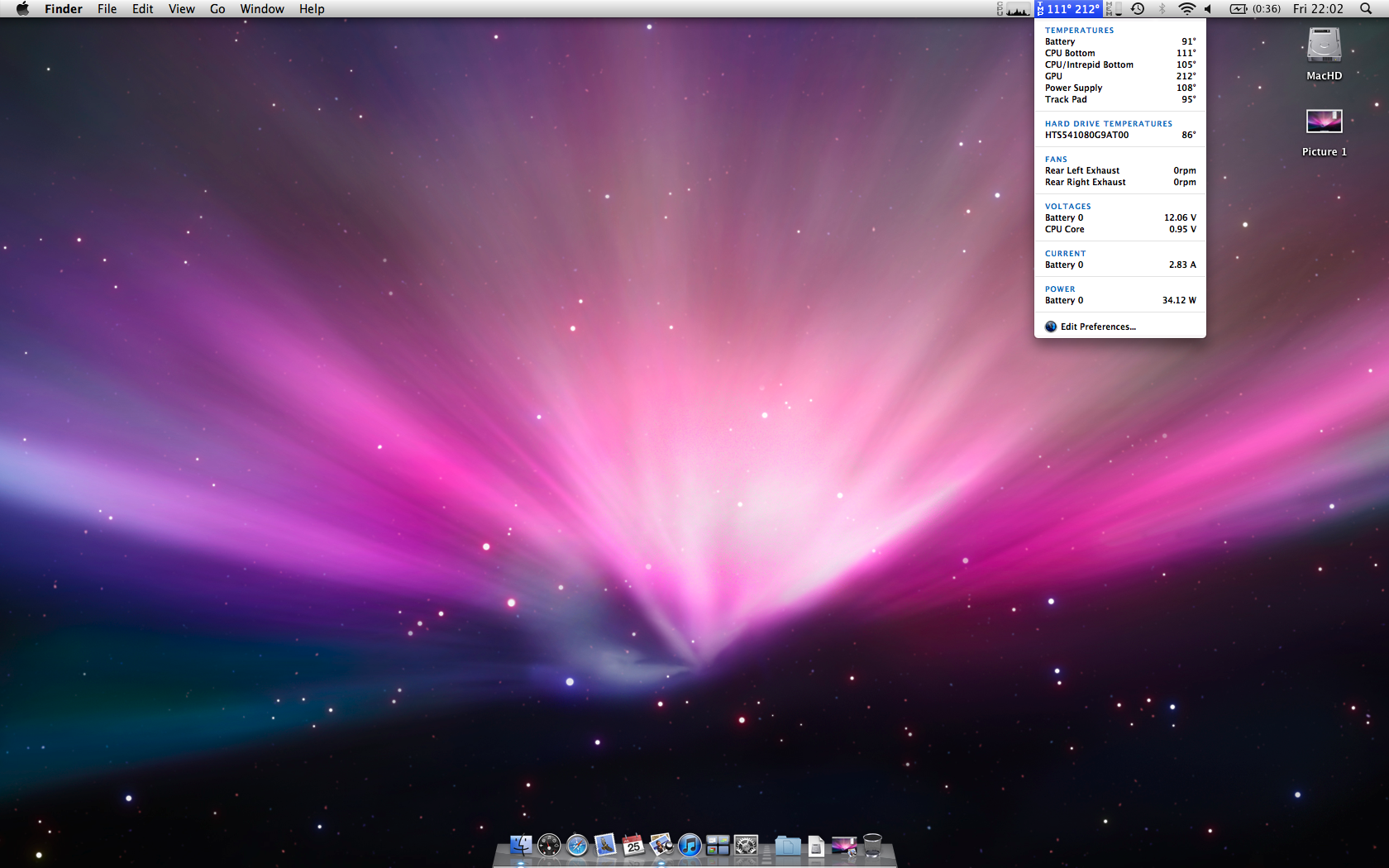

Wow just played some BlackShades for about 20 minutes and I took a look at my GPU temp and just about crapped my pants, it was running around 160 F. I've never seen it over 140 F. I should probably be pretty concerned about that, huh. 😱
If it doesn't shut down then I guess it is okay.
It hasn't frozen or shut down once.. and it didn't really feel that hot to the touch. But still, I'd be more comfortable if the temps were lower 😀
I noticed, that the heatsink is doing it's job on my PB well. While the lappy does heat up once it gets going, it cools down fairly quickly after whatever intensive task it encountered. For instance, I ran the game for several minutes, and temps were in the high 140s, but as soon as I quit they dropped down to around 115 (CPU underside) and 127 (GPU), which is around where it usually operates.

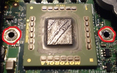

On the PowerBook Medic site he sells a screw set, which includes the standoffs and spring screws that I broke of the MB that help secure the heatsink, and someday I might tear down my PB just to see if I can resolder them on. I sortof doubt it would make a much bigger difference, however, and most likely isn't worth the trouble.
EDIT: The attachment I took when I last applied paste shows where the screws came off:

Those GPU temperatures are normal. The thermistor has a small range and being outside of that range causes it to loop. It won't show the real temperature until about 150F to about 220F.
Well my friend, you have a gifted PB 😀
56C = 131-ish I think, but that's somewhat weird, I don't think I've heard my fans reach 8K rpm, the highest I've seen at least is 7K.
Yeah, normally the highest fan speed I get is 7200 and that's fairly uncommon. This was at 8100 or so for 6 hours. I'm surprised the nearly 10 year old fan survived.
I wouldn't worry about the standoffs much.
Yeah, I figured it's most likely not worth the trouble and there wouldn't be a hug difference if any at all. I think the heatsink covers the CPU well enough, if you look closely at the attachment again, you can see the imprint of the copper pipe in the thermal compound.
It isn't going to cause much difference at all so why bother.
Ah, I wondered why the GPU was showing crazy temps and the fans were not interested in the slightest. Or why the PB had not shut down from overheating.
17" DLSD Hi-Res.
Come to think of it, if the PB is only showing bogus GPU temperatures under 150ºF, how come others are measuring temps of 120-ish?
Is it normal that my fans run at such different rpms on my dual 2.0 power mac g5.
Here is it running with Mactubes
