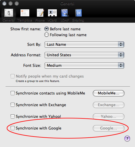

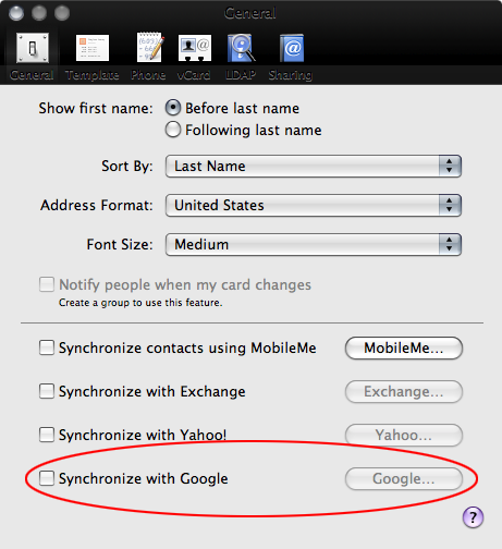

5. Connect AddressBook to your Google account.

Getting AddressBook to sync to Google
*Note that apparently, despite linking AddressBook to your Google account there is no immediate sync with Google. It's not implemented at least in OSX 10.5.8 Leopard. Fortunately, MacRumors came to the rescue. There is a Google private framework that forces a sync between AddressBook and Google.
Here's what I did:
1. At the link above is a terminal command to force the sync. Note that you must have AddressBook linked to Google or there will be an error. I copied the terminal command to AppleScript Editor and saved it as an Application Bundle. Here's my script:
Code:
do shell script "/System/Library/PrivateFrameworks/GoogleContactSync.framework/Versions/A/Resources/gconsync --sync com.google.ContactSync"
2. I added the terminal command as a daemon to Lingon. Lingon allows you to add little things that you want the system to run or do whenever some even occurs or on a timed schedule. In my case, I want GoogleSync to occur at login and every 4 hours. I set Lingon to execute this terminal command at those times.
3. I created the App bundle because I wanted to run this script when whenever I wanted without having to wait on Lingon. I use FastScripts and I assigned a shortcut to it. I also used Dock Dodger to let me call the script without seeing it appear in my dock. Just a simple CTRL+S (the shortcut I assigned with Fastscripts) and I get syncing.

How do you "link Address Book to Google"? I thought that was what the command was for, but apparently you have to link it first? What? Really, really confused. :confused: Help is appreciated.
Follow these instructions…
http://lifehacker.com/393855/enable-google-contact-sync-without-an-iphone-or-ipod-touch
That will allow the following to show in Address Book>Preferences…
Check the box for Google.
Note that so far I have not gotten the app to accept my account and password.
It's been so long since I've done this it's possible that it's not been working for years and I just didn't notice.
I do have the setting for less secure apps set to allow and iCal can login. So, not sure why Address Book can't.
Well, I'll try it anyway just to be sure. Thanks! :)
[doublepost=1496015938][/doublepost]Yep, not working. :( However, is it possible Google has an LDAP server?
