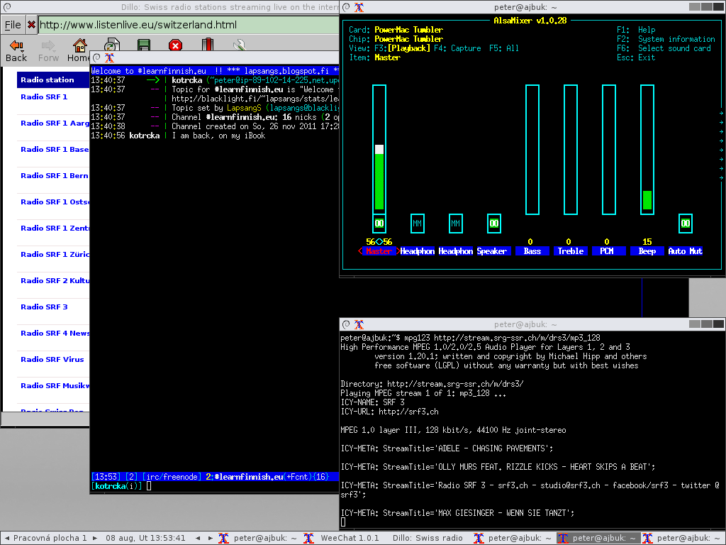

OK, I was not able to get more than 8 bit colour in 16.04 :-D So I have tried Debian again and it actually works if I do not use any heavy desktop env. I installed Fluxbox and yes, it is OK.
