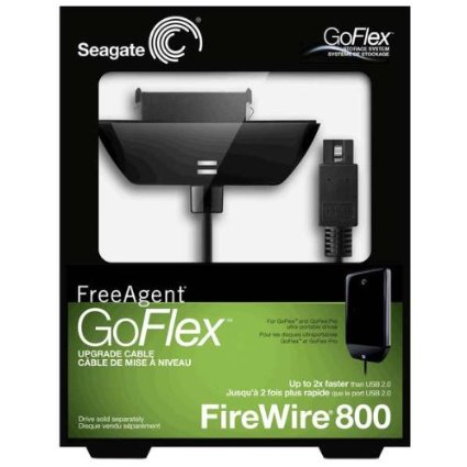

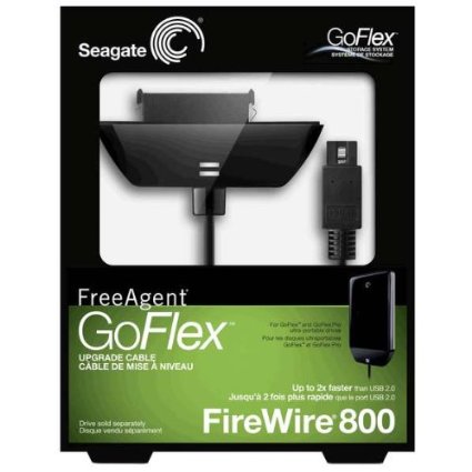

One of the cheapest that works is the Seagate GoFlex FW800 adapter. I picked one up for less than $20 on eBay. That will fit on any SATA drive and will also provide power for a 2.5" drive. You can pick up a 9pin to 6pin adapter for a couple of dollars if you want to use with an older FW Mac. Good for troubleshooting or if you don't particularly need a permanently attached solution.
http://www.ebay.com/itm/Seagate-GoFlex-FW-800-External-Hard-Drive-Adapter-/271851447983
