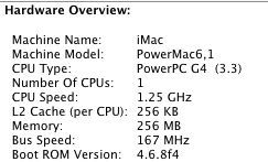

Here's a pic of the Hardware if anyone checks it out. Let me know if for some reason it seems incompatible.

I thought it was an eMac as well. They just described the specs to me and some other people on the forums said it should be an eMac. However after checking it out and looking at the hardware specs I changed it to the appropriate title.

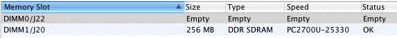

Take a look at the picture. So this is telling me that the computer has 256Mb installed in the main slot; the one inside the computer.
The user accessible RAM (the laptop RAM) has nothing installed. ya?
I know you're supposed to match up the RAM, but would 256Mb in the internal RAM and a 1Gb card in the SO-DIMM slot, would that work??
That appears to be what your screenshot shows. Personally, I'd just stick a 1GB stick in that slot and not worry about the internal one, since 1.25 should be pretty comfortable, and those can be a bit of a pain to open up fully. You can always crack it open and swap the 256 for a 1GB stick in the future if it becomes necessary.

Actually, matching sticks shouldn't matter at all on that machine. That only really makes any difference on systems capable of doing dual-channel, which the G4 isn't. The stick you linked looks like it will work fine, but personally, I'd get one of these:
Get small Philips screwdriver, remove bottom plate and see. It'll take 10 seconds 🙂

I can vouch for OWC as well. That's where I got the memory for my iMac, and it works great. Yes, your screenshot shows only the internal slot has a memory stick in it (as they didn't ship with the internal slot empty from the factory). Throwing a 1Gb stick in the easily accessible slot should suffice.
