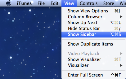

You need to turn on the Sidebar from the iTunes->View menu.
I know how to show the sidebar. What I am asking, when I copy the music and playlist to the iMac, I open iTunes 11, I want to make sure all of the playlists are listed.
