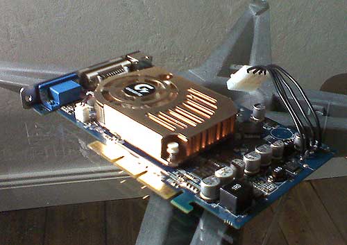

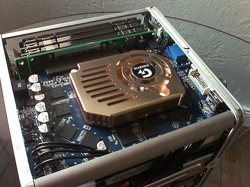

Well, i can add the meanest thing i ever got to run in a cube to this collection. It's the one from my avatar pic. A flashed GeForce 6800XT.
Sadly a Giga-C VRM is needed just to get it to run and there was no way to keep temperatures in a safe range inside the outer case. So this is not exactly what i would call a cube card.

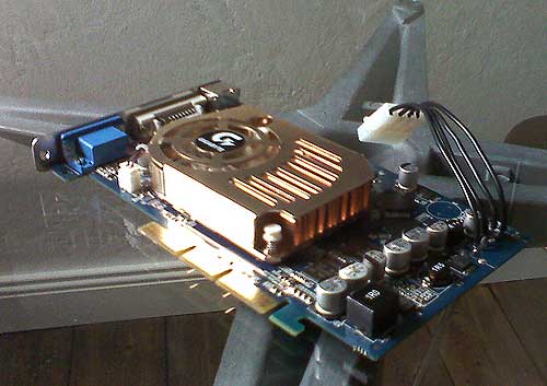

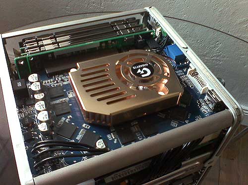

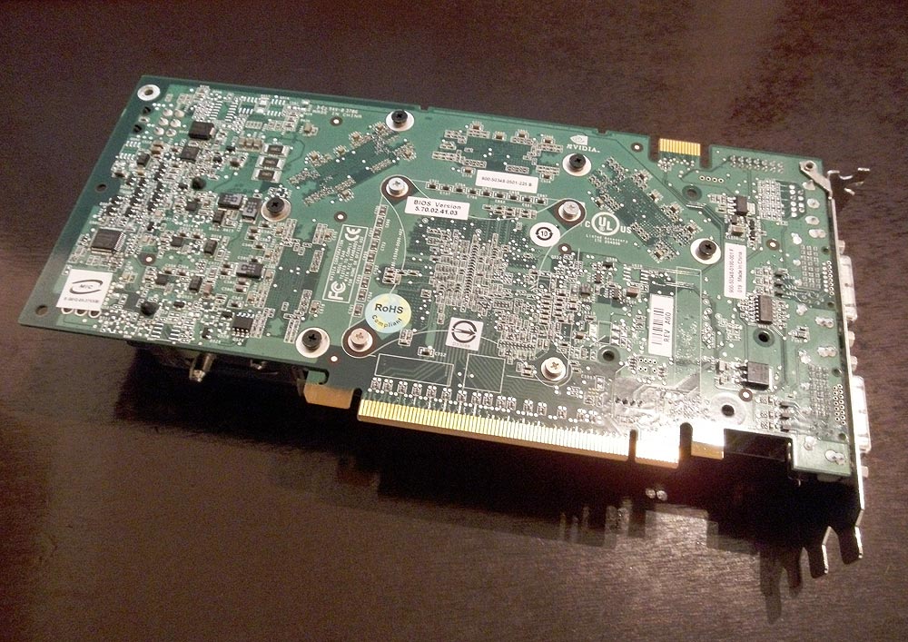

Next one with a pic of the backside, to prove it is the Quadro with RAM-chips only on the frontside. It's a flashed PC-card and yes, it is PPC ready. 🙂
I have seen discussion around this topic in some of the other threads. So if anyone still has one of these around and likes to use it in a G5, now there is an "unofficial" ROM-file for this one too.
