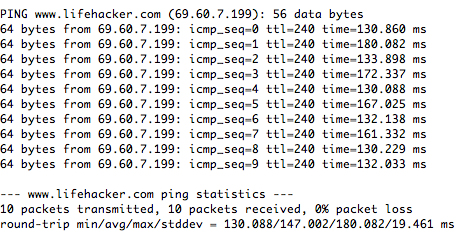

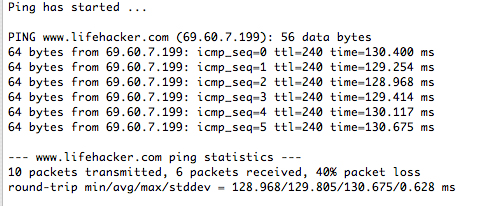

My PowerBook G4 had no packet loss - the iMac had %40 loss

After I rebooted the Linksys router and have done ping twice on the iMac w/o any packet loss
