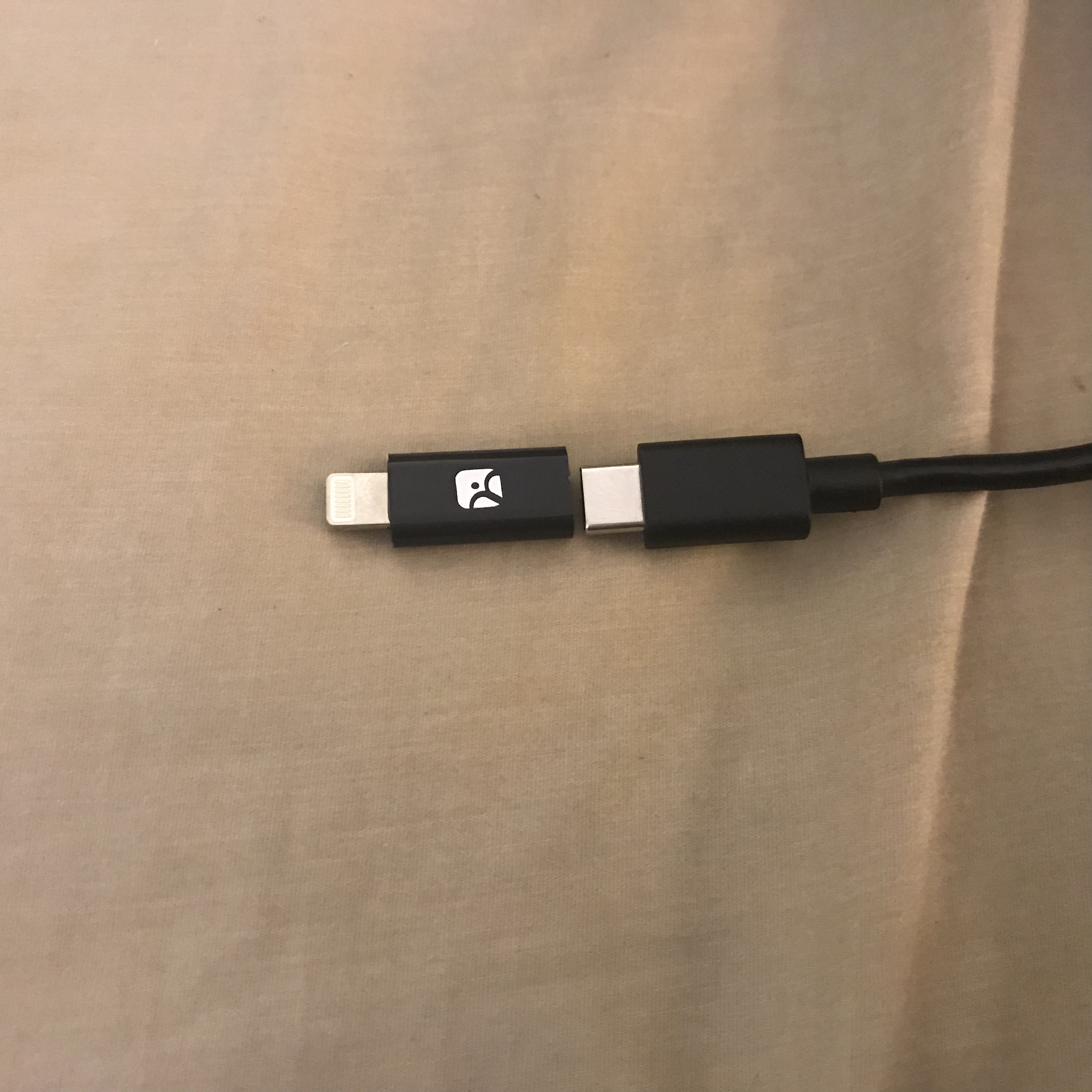

Charger Output : 5V/1.5A and 15V 2.6A
Blackweb Adapter for Nintendo Switch from Walmart $17.99

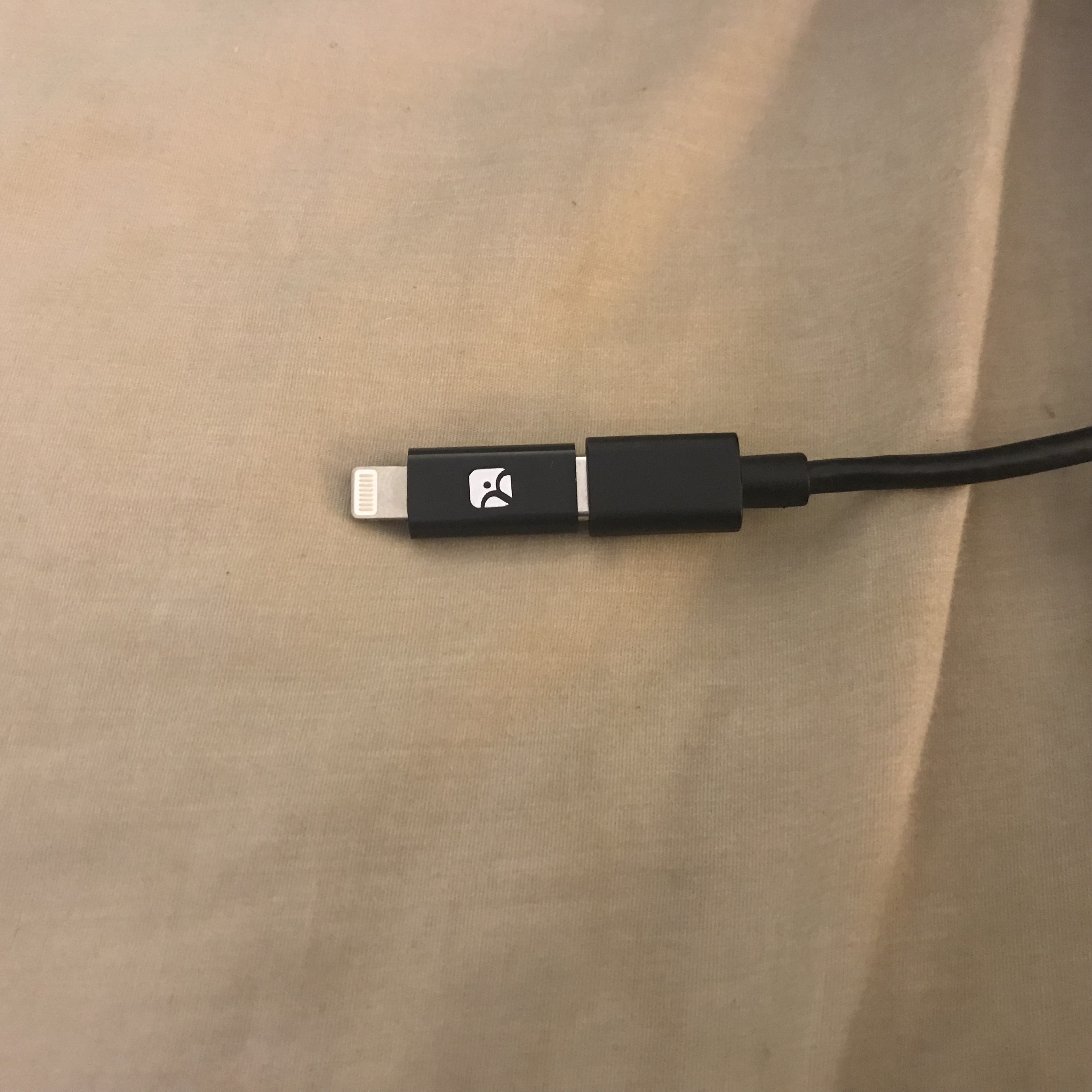

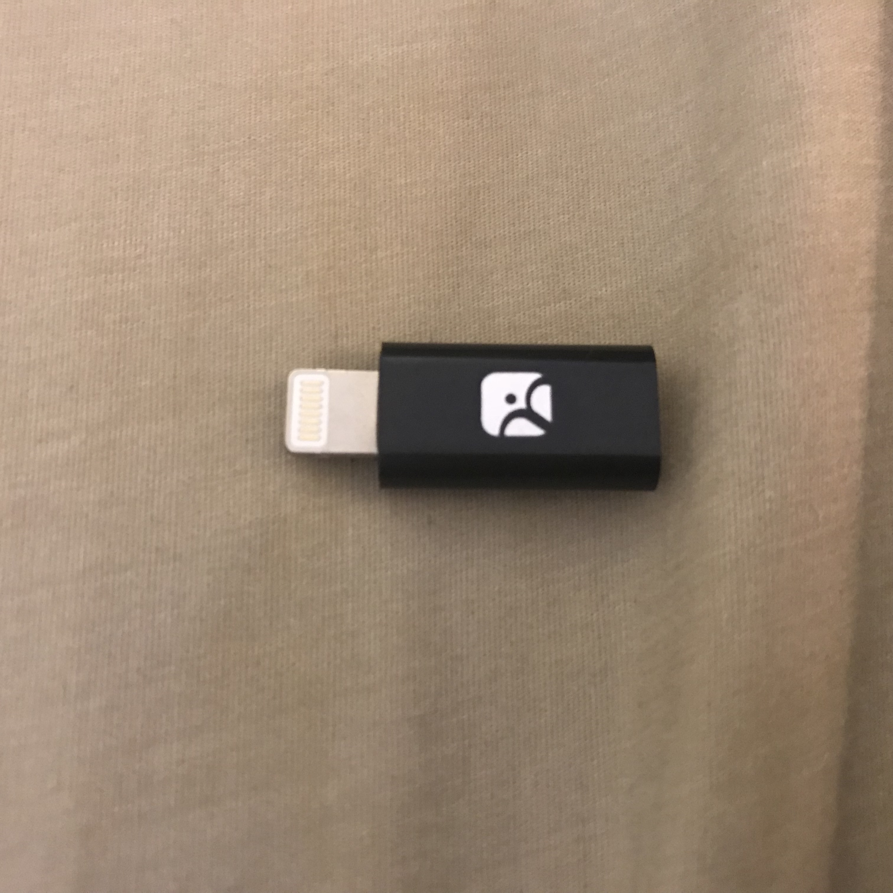

The small adapter is female C to male lightning bought from Amazon for $7.99
https://www.amazon.com/gp/product/B07213RDKN/ref=od_aui_detailpages00?ie=UTF8&psc=1
How do i know if the charger is pushing the full power to iPhone 8? Because there are 2 options on the output on the charger as you can see from my description & the box picture.
Don’t feel like spending $80 for officials fast charging apple accessories.
EDIT: Or do i need to i buy different cheap adapter with USB ports and use apple’s usb-c to lightning cable?

You need to use Apple’s USB C to Lightning cable. It’s the only one certified and thus won’t be rejected. So that means you need a different adapter that Apple’s USB C to Lightning cable plugs directly into. (You we’re right to grab one that works for Nintendo Switch in a way though, as both iPhone and Switch require the adapter to be USB C Power Delivery 3.0 capable).

Wow that’s really good to know that its only the apple branded cable so far which can be used as fast charging i have another wall charger which has 2.1A output and has a USB port. Do you think this will charge fast if i use Apple’s USB-C to Lightning cable?
