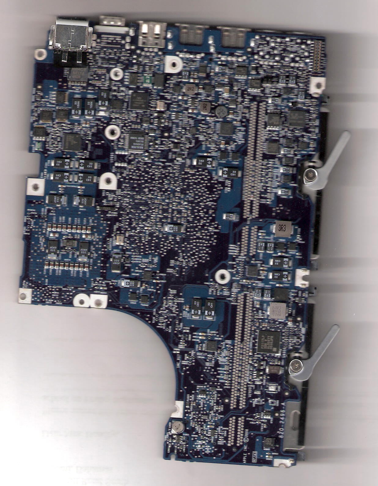

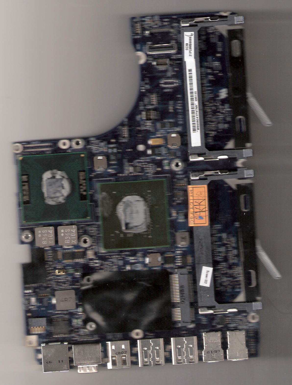

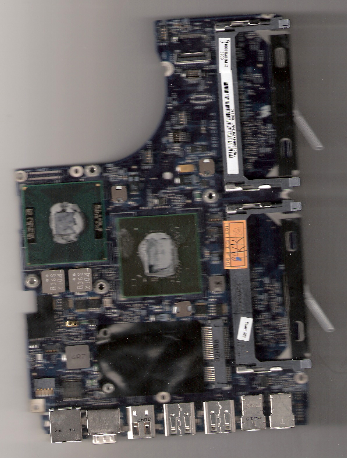

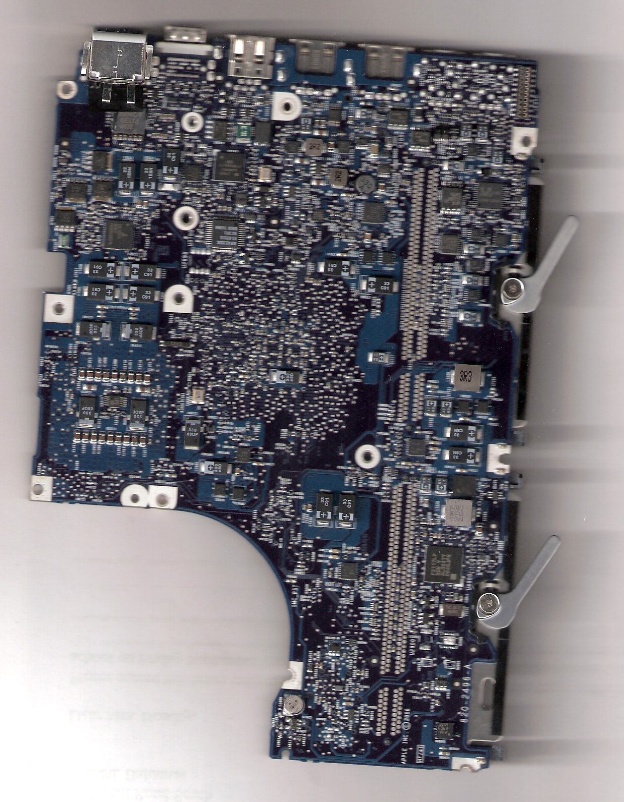

please can some one help me out. Ive got an early 2009 macbook 13". Got it at a deal from someone who apparently locked it and could not get it to boot again because they lost the password! It was taken to an authorised dealer wo claims it is not under warranty for this issue and that a new logic board is required... I found this hard to believe and since i feel if i was to be given the right direction i maybe can fix the issue... so i do a PRam reset but the system would load with a question mark as was doin before i did the pram reset. i stripped it and saw there was no PRam battery in the system.. am i missing something, could this be the reason? So i ordered a PRam battery tried to insatll it but could not locate a connector on the board to install the Battery,,, so please help me out to find what i am missing! Macbook 13" white 2.0 core 2 duo 2gb mem

thanks for the link however i have always frequented their site for help however the board they show is a different model a you should see from the pics, and if you zoom in on my board i dont see the connection... any frther help is greatly appreciated
I just went and looked at that iFixit page again and noticed this:
The PRAM battery on early 2009 MacBooks is non-replaceable.
I guess this answers the question of where the PRAM battery connects to the logic board. I bet it uses the capacitor method like the iBooks did.
