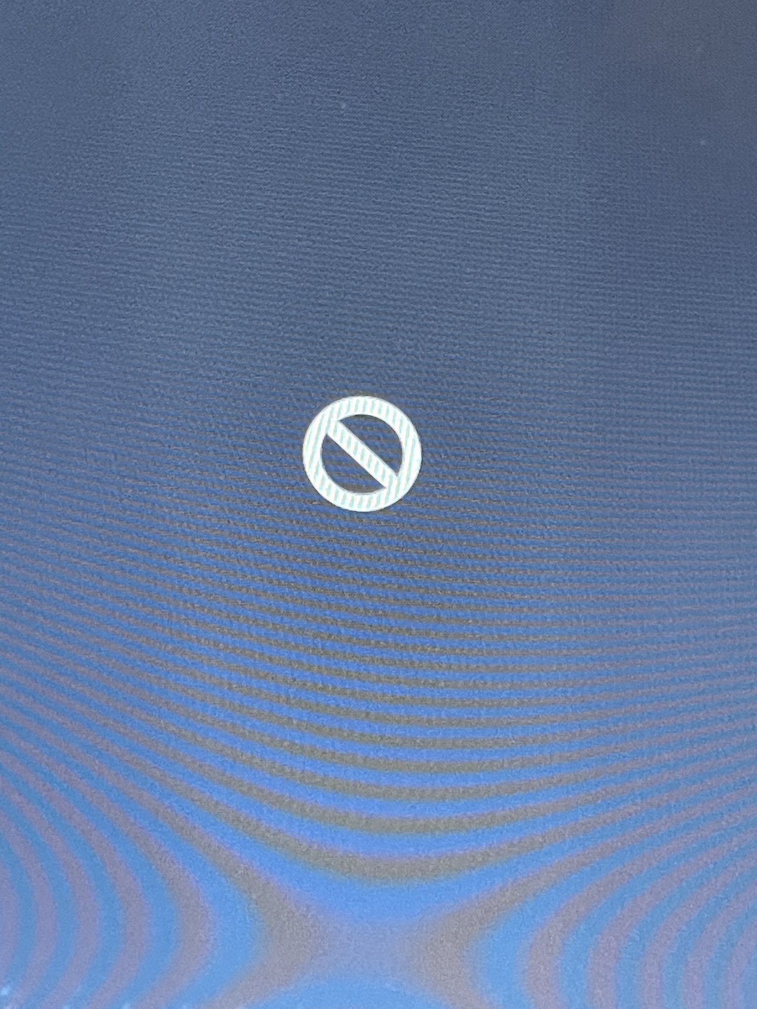

Just as a word of caution if you’re thinking of resetting your PRAM make sure you have a back up. I mean make sure you have a back up all the time but in this particular case I did that to my 2018 Mac mini and it would not boot. I got the lovely “Your computer restarted because of a problem” message then the circle with a line through it.
Hopefully the time machine restore makes it bootable but I’ll know in four hours 😂

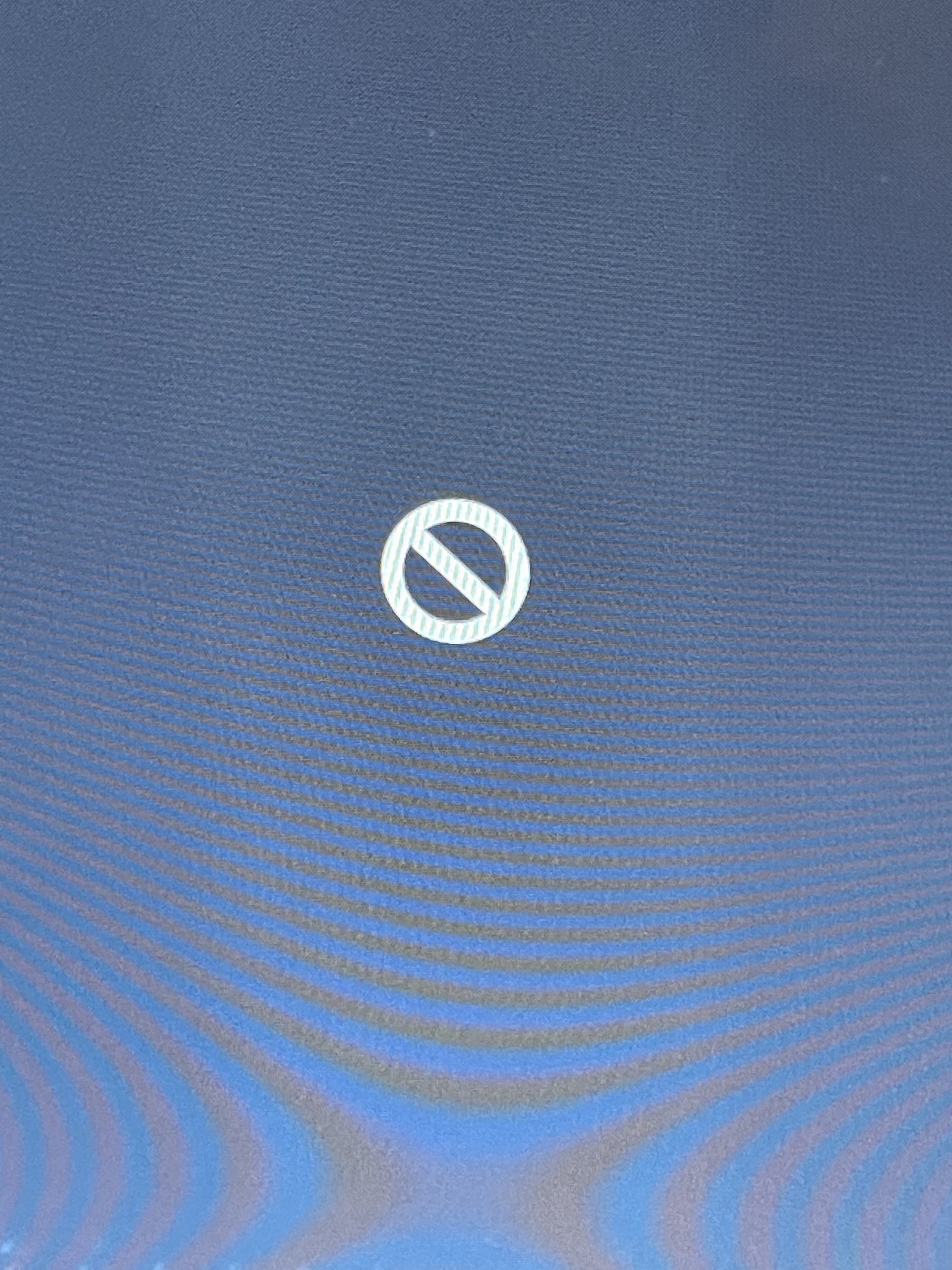

Great now after the Time Machine restore I have a smaller circle with a line through it 😂
Reseting PRAM shouldn't affect your macOS installation. Therefore, all you should have to do is hold option key at boot and reselect macOS.
No I tried that. It just shows up the hard drive and when I select that I get the same failure. I also tried the first aid option for the disc

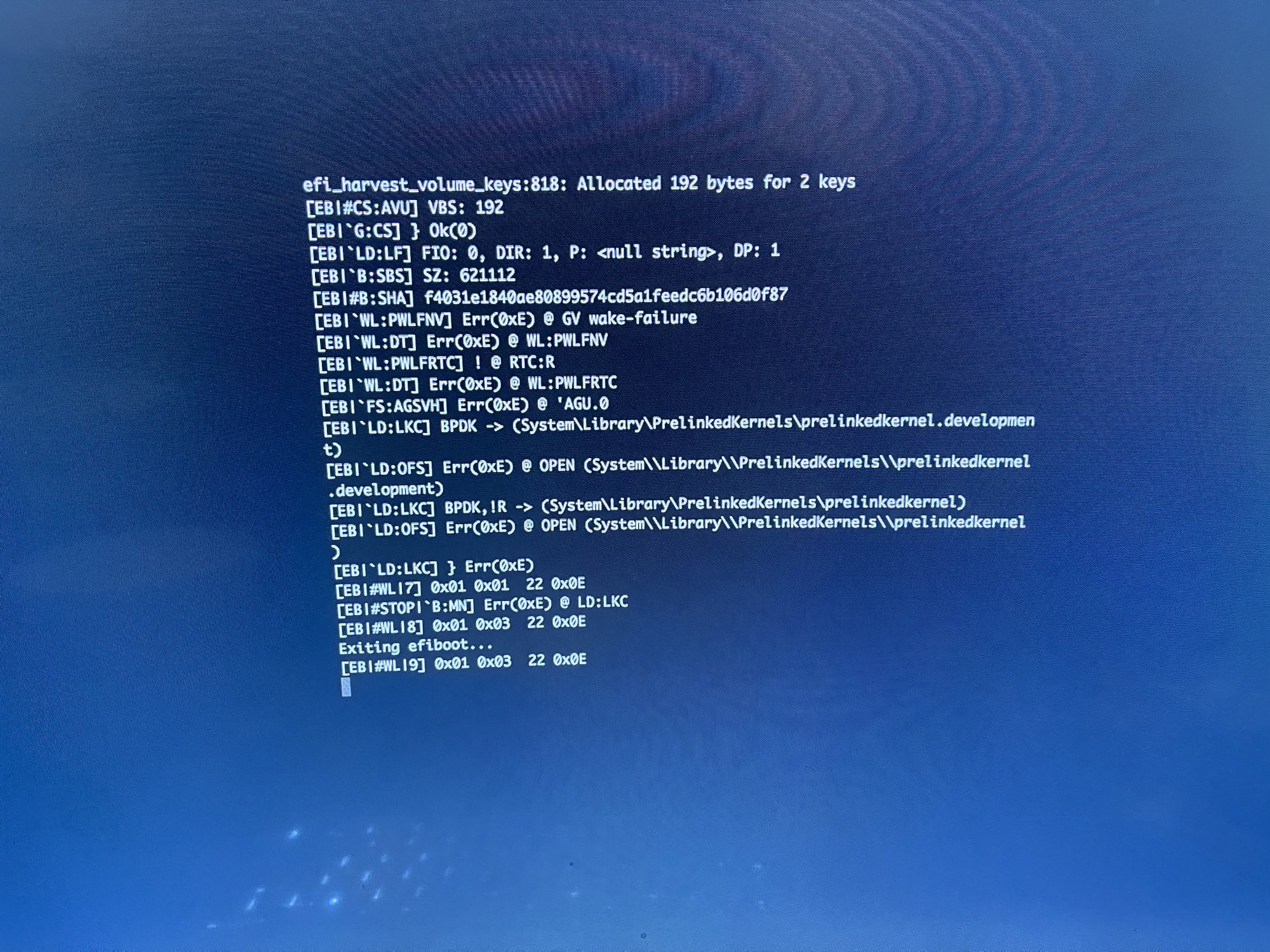

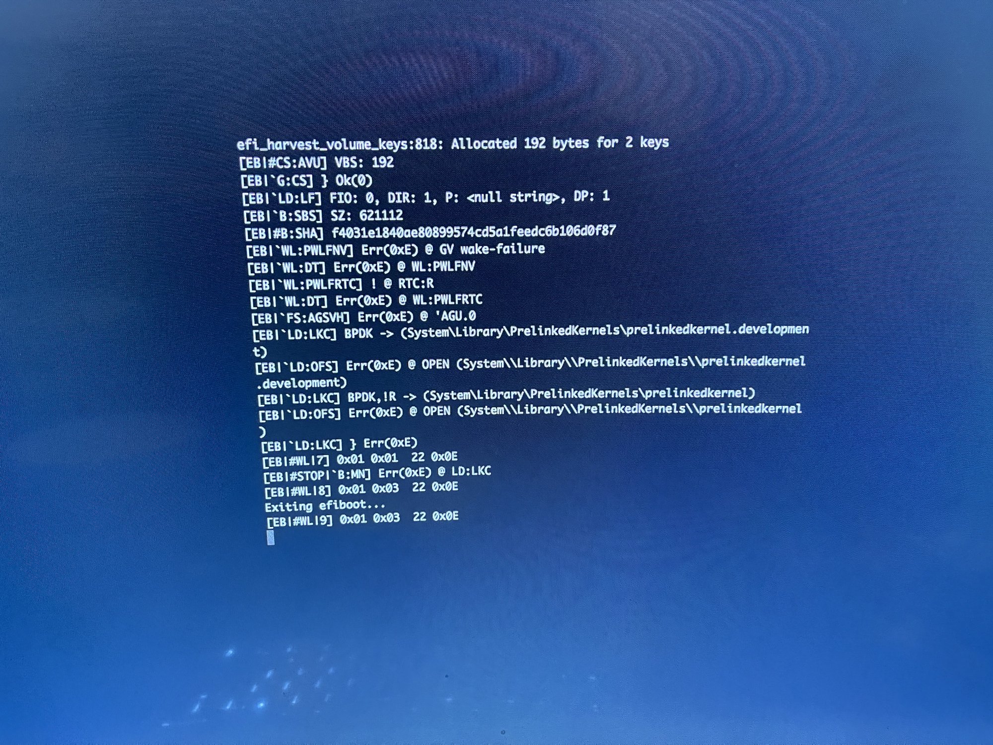

Boot the installer and enable verbose boot by adding -v to boot-args NVRAM variable in Terminal.app.
