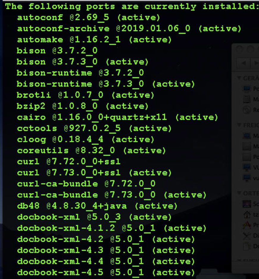

Negative, after runnig you installer cmake is not in the list and is also not executable.
sudo port install ffmpeg +gpl2 ist starting with compiling cmake and the compiling ends with the known error.
i test the installer again.
Pehaps sudo port clean --all cmake will help. Test it.
Like do a normal port install cmake, see the list of what it wants to install, don't install cmake, but install all of those dependencies listed manually, then run the installer.
