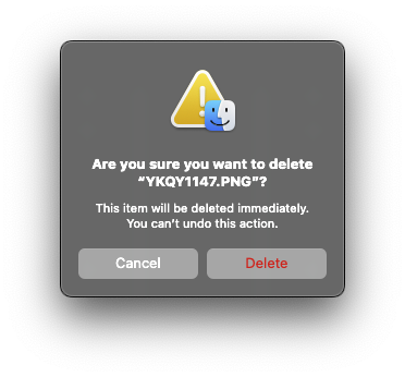

Oh seriously? So much of this stuff just isn’t documented and doesn’t come up when you search for it… so in finder, you select a file on the synology, right click & choose move to trash, or use a trash icon on the finder window’s top bar, or drag it to the trash on the dock….

Relative to Post #18 comments, it's unusual that someone is as concerned as you are with maintaining trash access. Usually, things that go in the trashcan are not meant to be recovered. Of course, they can be until it is emptied but the idea of trash is that you are likely NOT going to dig through the trash to recover something. Your comments read like it's almost like another storage well for you and that access to trash is very important.
I think it's the combination of insta-delete, and the Synology snapshot recovery being something that requires busting out a web browser and logging in to DSM.
You also make the comment about wanting to keep what appears to be multiple TM backups for the long term (restarting with new TM backups when old ones are full). If files are that important, don't put them in the trash. Then, it's just keeping your non-trashed files & folders organized so you have access to them for (apparently) many years.
I like a safety net on deletion actions, pure & simple. Also:
I prefer the aesthetics of the trashcan experience, Vs. the network deletion.
And I don't think TM should be viewed as some kind of archival manager but just backups for what is on your Mac now. For archives, store your files in organized folders and back those up to more than one bigger storage option, ideally with one full copy kept offsite and regularly rotated with the onsite copy so the offsite one is always fresh.
