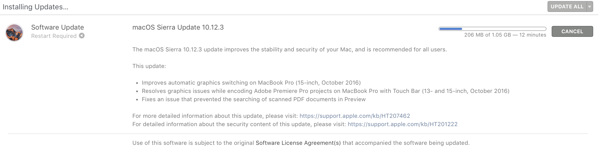

Seems the new macOS update solves the issues. Hopefully it helps!
Well look at that! Gonna give it a shot this week.
Reactions: Sanpete
General and I am downloading it now. I really hope it helps with other graphics glitching I get in a number of programs.

And ouila there's the software update that fixed the problems that we have been saying for weeks are...software and driver issues.
