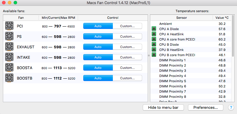

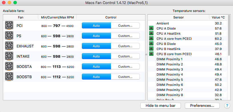

Follow up question, promised I did some searching on this but having a hard time triangulating the data. With the recent upgrade to the 2 x 3.46 GHz 6-Core Intel Xeon, wanted a sanity check on idle CPU temperature checks.
With an ambient temp of 30.2 celsius, CPU A Diode is 55 and CPU Diode is 43. From what little I can gather seems a little high?
