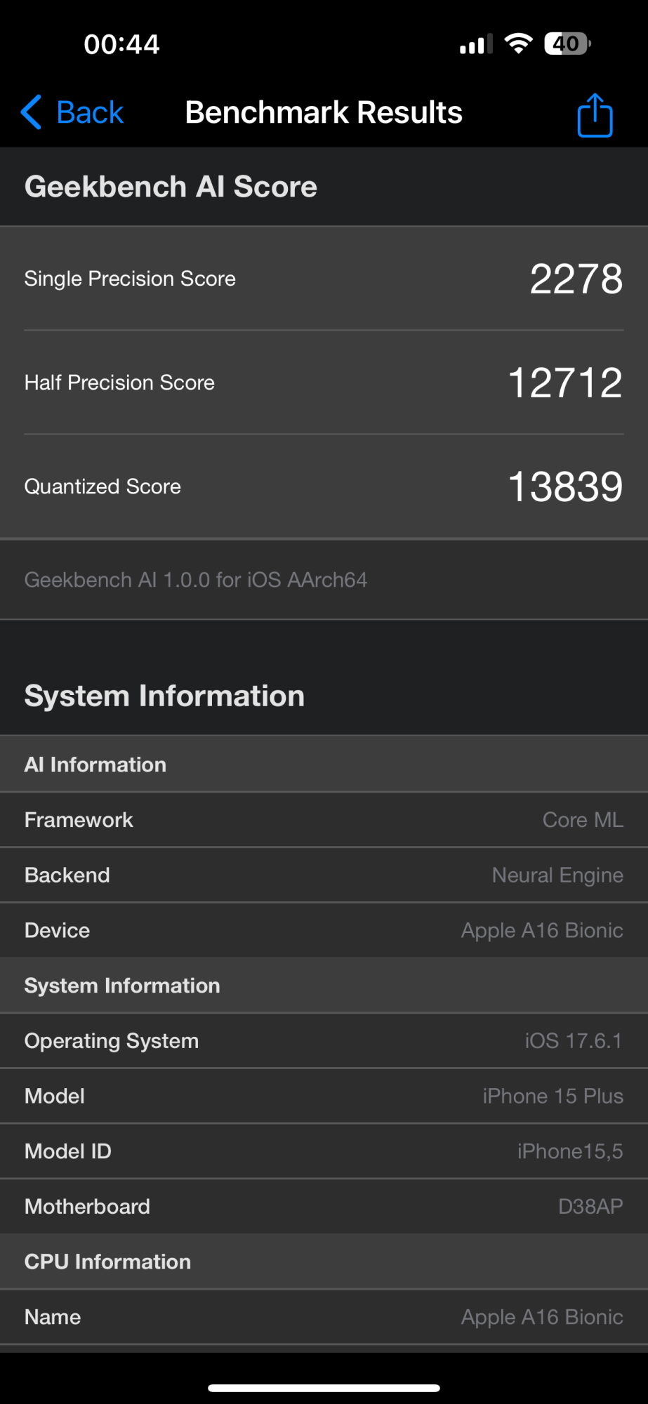

My iPhone 15 Plus, which scores (Neural Engine) are higher than MacBook Air M2 that the article shows, cannot run Apple Intelligence.

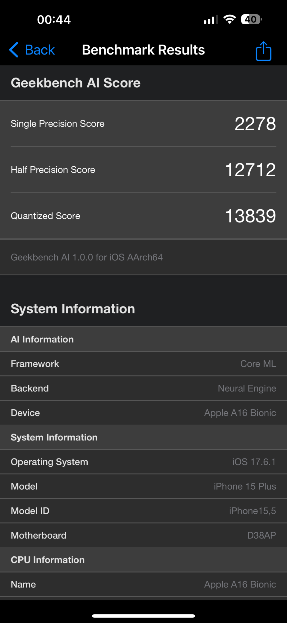

View attachment 2406715My iPhone 15 Plus, which scores (Neural Engine) are higher than MacBook Air M2 that the article shows, cannot run Apple Intelligence.
