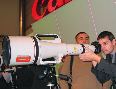

The Canon EF 1200mm f/5.6L... 36 pounds and around $80,000 USD. 😛
Gawd, his shorts are hawt! 😀
Seriously, though, I <3 my not-nearly-so-big prime. Not good for every purpose. But I just don't see reality allowing for the kinds of things the fast primes can do with a zoom lens anytime soon.

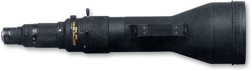

Now that you've seen Nikon's largest, here's the smallest...
The 45P, which I'm sure looks just darling on the D40!
