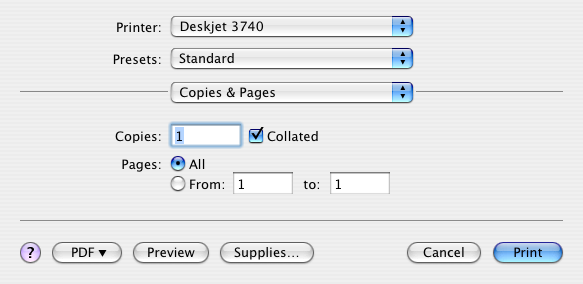

File -> Print
There should be a "PDF" option if the program uses a standard Apple printer dialog. If it does not use this dialog, then there is usually an option to switch to the standard Apple printer dialog.

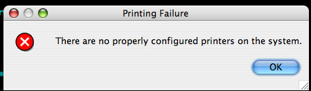

Thanks, however, since I don't have any printers connected to my machine, all I get when I select File->Print is the following error message:
That's what I want to know how to do. Do I simply select any printer and set it up?
You should still be able to access the printer dialog even without a printer installed. The program you're using must not use the standard Apple dialog.
