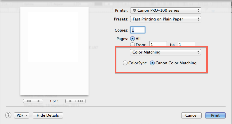

Your Print Dialogue box will open once you have a document open and try to print it. I have posted a photo below to show you what benwiggy is talking about.

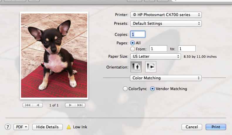

Thanks to both of you. Unfortunately, what you're showing in the photo is somewhat different than what I'm finding. I have two options..They are "ColorSync" and "Vendor Matching". It's currently set for ColorSync. Should I change it to Vendor Matching?
Yes, change to Vendor Matching. Mine is showing Canon due to the fact that is the type of printer I have. That,s all and cute pooch by the way.

Thanks so much. You just saved me a bunch of money. And thanks for complimenting my pooch. She's 3 months old today!
