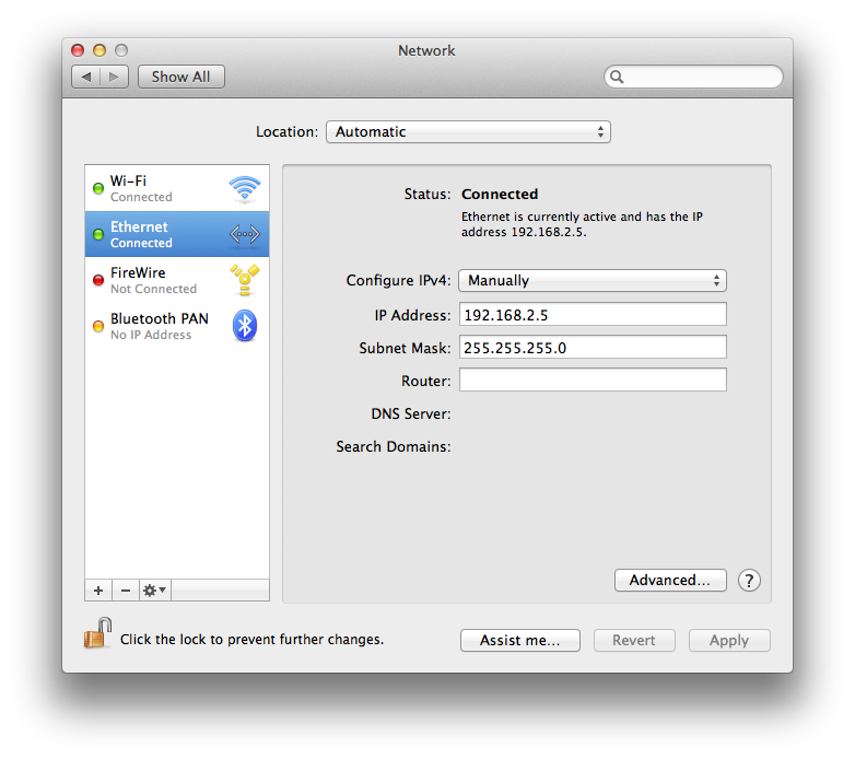

See the attached screenshot. Click on the cogwheel to select "Set Service Order".

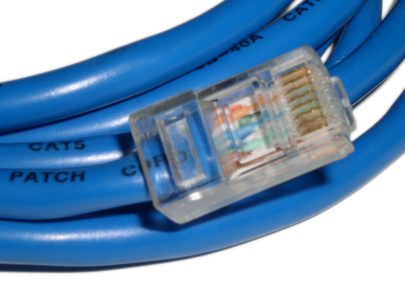

the printer is connected directly into the back of the iMac - but not with an Ethernet cable; I'm not sure what you call it, but it's a telphone jack type of connector.
That sounds suspiciously like an Ethernet cable.
In Network preferences, is the little dot next to the word "Ethernet" green? Or is it yellow or red? I thought I had attached a screenshot to the last post, but apparently not. I'll try again here.

Hi Bigwiggy - The little dot next to the word Ethernet is green. However, typing 0.0.0.0 directly into my web browser results in an "Unable to Connect" message. You're right about the cable being Ethernet - I looked at it under a magnifying glass and and saw on Wikipedia the same cable, which has 'Cat 5' embossed on the external part of it, same as mine😎 However, I wonder if the printer control panel is a red herring as I've never raised it on this printer, which is, I should add, perhaps 8 years old, maybe even older! But it is an astonishingly reliable and productive workhorse and I've very reluctant to lose it. Any thoughts about Airport not being visible in the Network pane? In the Network window I see the IP Adress 192.168.1.69, Subnet Mask: 255.255.255.0, Router: 192.168.1.254, DNS Server: same as router but grayed out.

If you look at my picture, Apple calls it "WiFi", not "Airport". Those IP numbers sound like typical network settings, which suggests that you are connected to your wireless router. They're greyed out because the padlock is on, but you don't need to mess with them.
