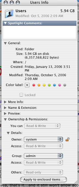

probably what you need to do then is do a Get Info on the folder you're trying to copy to and, in the Ownership and Permissions tab, make sure that the Owner is set to System and the Access is set to Read & Write. Also make sure the Group is set to Admin and the Access is set to Read & Write. If you click on Apply To Enclosed Folders it should take care of all subfolders.
and yea, I'm running 10.3.9 on my old G4 and it's been as solid as a rock.

Yes, that's how it is in the Get Info window.

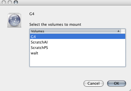

after you pass the login window, you should see the select volumes to mount window...what do you see there? Do you have the option to mount the system HD or just the Users' home folder?
Example: when I log on to the old G4, I get the window pictured below. G4 is the system HD, and "walt" is the User folder...

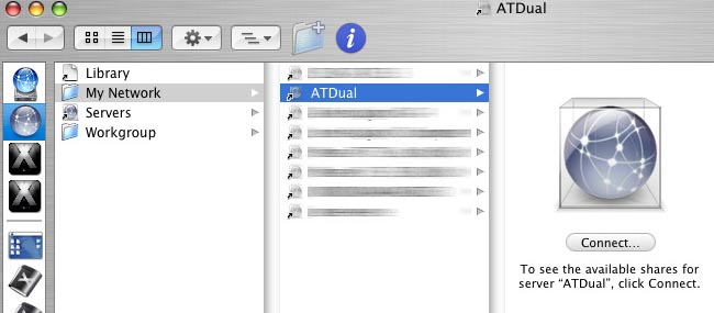

This is the way I'm connecting (attached)
As far as Maya it's very tricky, Maya 7 is qualified on 10.4.2. This is the version I'm using now. I just upgraded to Maya 8 which is qualified on 10.4.7. Until I get everything working on Maya 8 I would like to keep the OS at 10.4.2. Maya 8 seems fine on 10.4.2 but I have not hooked up the mental ray Satellite which allows me to render to both computers (6 cpu renders). The Satellite setup is painful, it involves code and lots of tricks to make it work.
