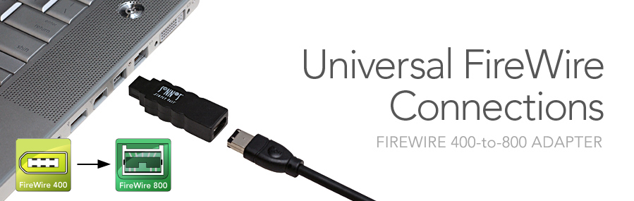

I just bought the 2012 iMac, reluctantly, because of lack of firewire. The guy at the store assured me that the adapters provide solution. My interface is firewire 400. There are no thunderbolt - 400 adaptors. So I had to daisy-chain 400 - 800, then 800 - thunderbolt. Salesman assured me no problems. Reality suggests otherwise. First try - half volume, lost frequencies, crackles and pops. Second try, fuller volume, questionable frequency range, ... but can I trust it at all for professional work?

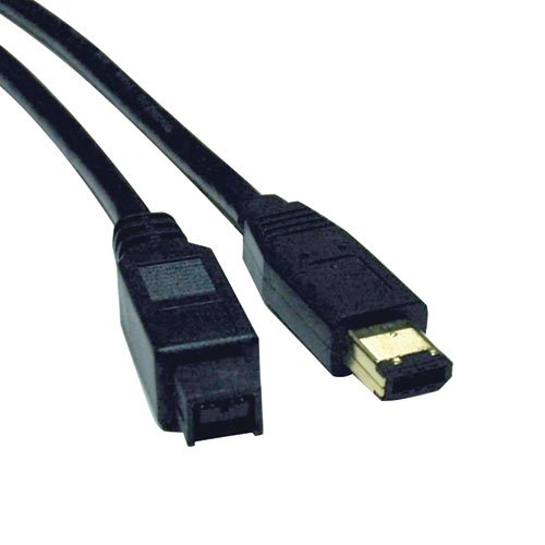

On a completely unrelated matter, FW400 has been banished from Macs for a long time, that's why you find FireWire800-to-400 adapters everywhere, after all it's just a different plug with 3 more pins.
Or you skip the adapter and get it as a cable.

Okay, I just heard of these 'bilingual cables' but there is still the need for one adapter which makes me uncomfortable.

Make sure to get a firewire 400-800 cable, adapters can be used but the cable is a better option in my opinion to reduce interference and technicalities considering your going to Thunderbolt Adapter..more adapters on the chain the chance performance issues occur.
Also, ensure the firewire 400-800 cable is double shielded, that also helps with interference.

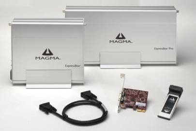

It costs more but here's what the pros are doing:
Thunderbolt to Magma Box.
Magma box hosts PCIe siig fw400 card with Mac compatible chipset.

My firewire interface works with a 400-800 firewire cable and thunderbolt adapter.

I am a music producer, and work with Logic 9 on the new late 2012 iMac, 27" i7, 680mx, 1tb fusion drive and 32gb of ram. I use a focusrite Saffire pro 40 which is a FireWire 400 interface, and have the apple thunderbolt-FireWire adapter, and then just use a FireWire 400-800 cable. No issues at all.
