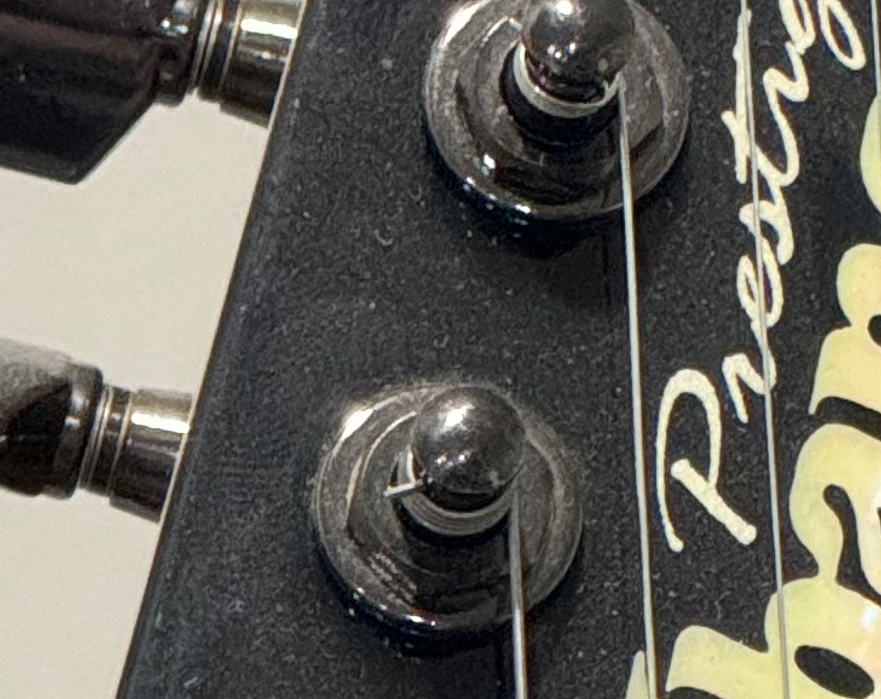

I was experimenting with Camera on new iPhone 15 Pro Max that I just got yesterday. I upgraded from an iPhone 11 Pro Max. I am not a professional, just noticing some unexpected behaviour from this.
Using the Camera App, pictures I take pressing 5x zoom often are using the Main Camera. Seems that if I Press 5x on an object that is close it uses Main Camera but crops at the 5x zoom level resulting in not as clear of image, but if I take a picture of something further away it is using the Telephoto Camera. Maybe the iPhone is detecting the closer distance and decides not to use the 5x lens, could be because of focusing limitations?
Here is a crop of a picture taken with Camera App, I cannot get to use the Telephoto Camera after several tries, and it actually uses the Main Camera and performs digital 5x zoom. Confirm this is the case in Photos app - Main Camera 24mm f 1.78
Distance is approx 3.5 feet.
Crop of picture taken using ProCamera App set to use TelePhoto Camera 5x Zoom. Confirm using Photos App that is using Telephoto Camera 120mm f 2.8
I am sure this is something that not too many would do anyways, just something I noticed; I am sure that if I go outside and take long zoom pictures using Camera App (as intended) it will (hopefully) always use the 120mm camera, which is probably meant to zoom in on far away things, not make closer things bigger like I was trying to do.

Yeah the 5x telephoto cannot focus on an object located closer than 1350mm (~4.43 ft) away. If you try to focus on something closer than 1350mm, the camera app will use the 1x lens and digitally crop.
