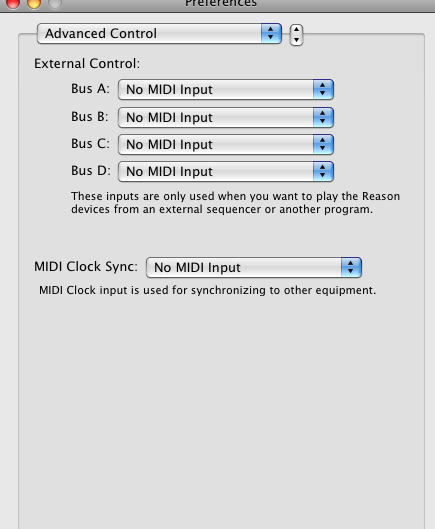

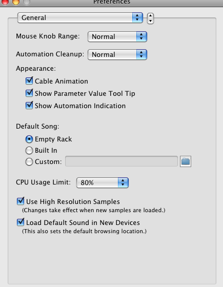

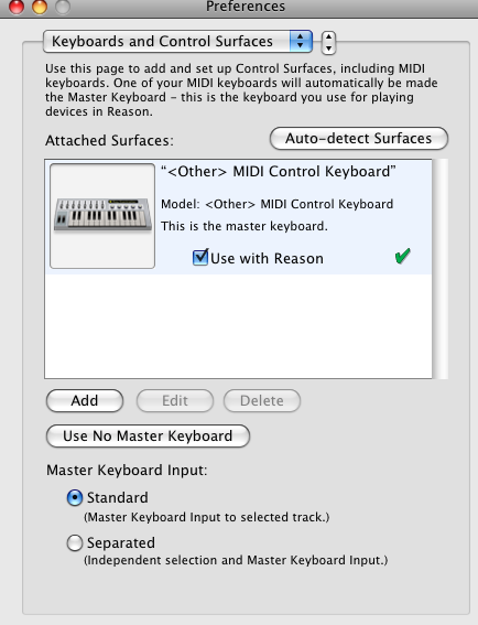

What are your audio settings in Reason? (Bit rate, etc.)
I had him send me some screen shots. Is this everything or is he missing an important panel?
I was looking for the Audio panel, but it looks like the problem was found.
