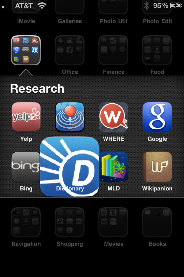

Need some help. I was moving some icon images over to my Suave HD theme but am finding something strange. When I move the images over, even if sized correctly they show up very large on my iPhone 4.
Below is a sample.
Any guidance on how to correct this would be appreciated.

Those are probably @2x icons named incorrectly.
Reg size 59x60
2X size 118x120

Are you using the old icon.png method from 3.x? For the iPhone 4, you have to use the "bundles" method. Please refer to the bottom of this post to learn the method that works. http://macthemes.net/forum/viewtopic.php?id=16791688&p=2

Thanks, so what should I name it. For example...
When I place Yelp.png into "Suave HD.themes/Icons" the icon is used by the theme but too large. When I name it Yelp@2x.png it does not get used by the theme.
Any advice is appreciated.
