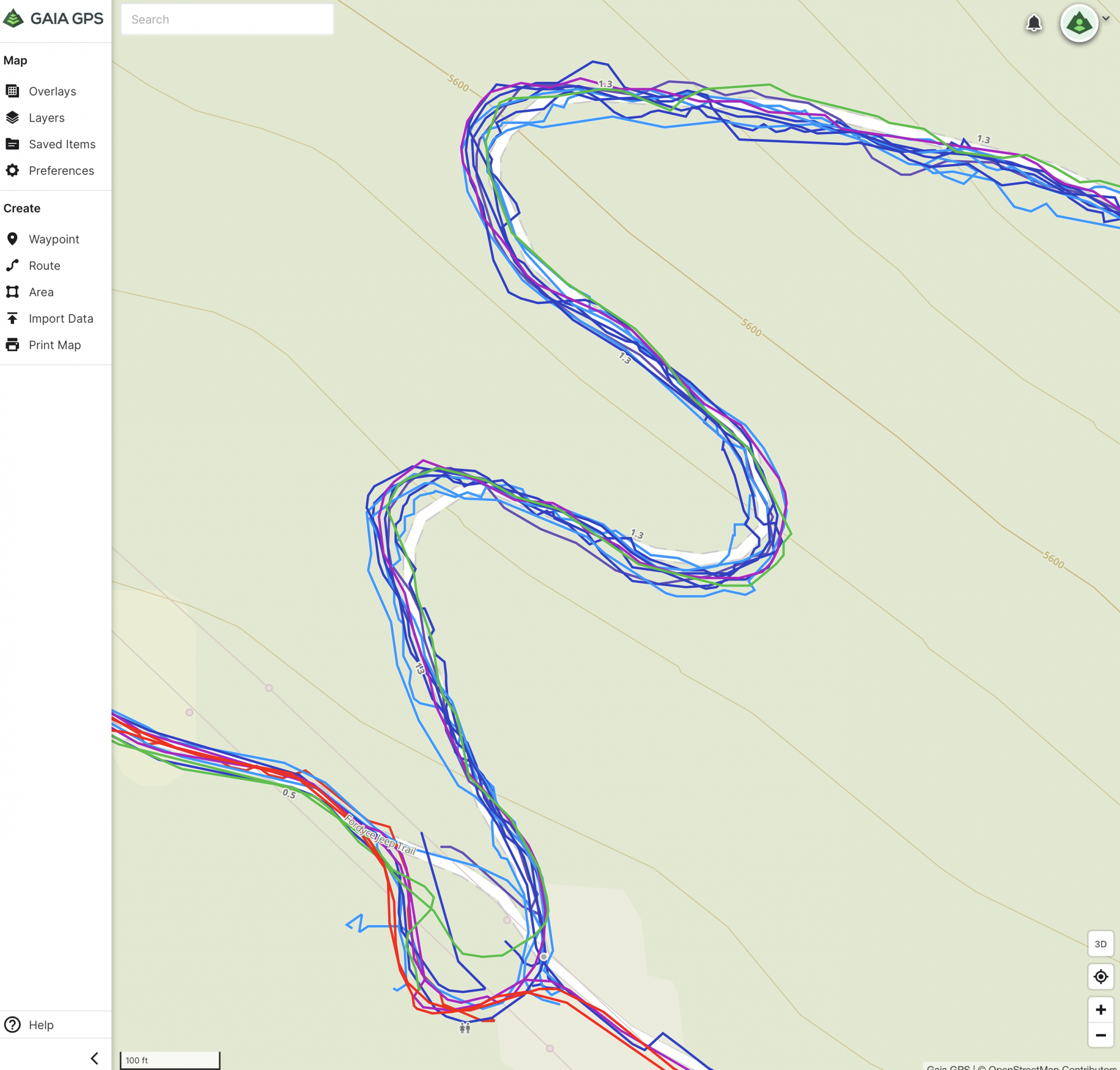

Here is tracking using iPhone/iPad for trail runs on different days. This has heavy tree cover so GPS reception is not great. Gives an idea of horizontal accuracy (see the scale on bottom left). Maybe 25 ft?
I agree, altitude is not accurate. But elevation gain/loss is not too bad.
Reactions: Boyd01
