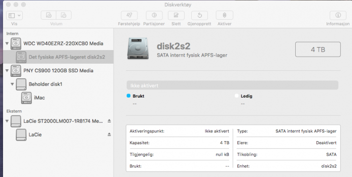

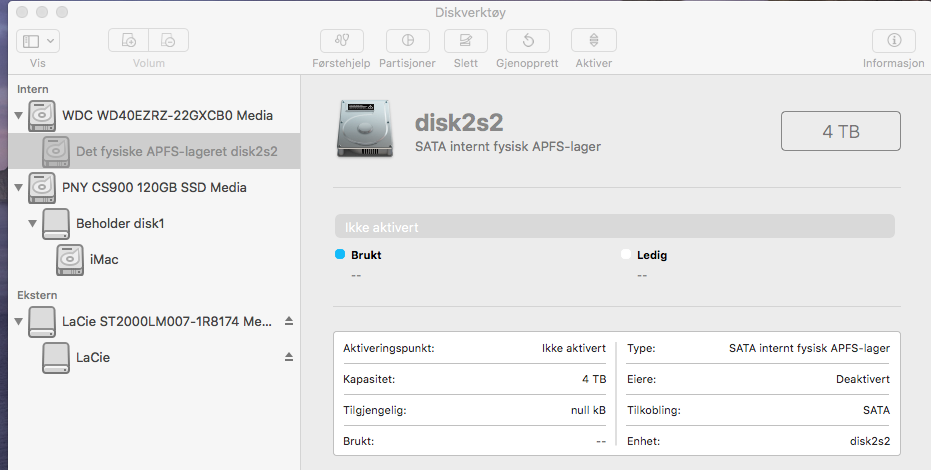

Imac 27" with 120 GB SSD start disk"disk2s2". 4 T SATA disk for storage. Screenshot attached.
No disk icon on desktop for the 4T disk as I normally get for both the start disk and storage disks.
2nd line is translated to "The physical APFS storage" - "Not activated."
Tried to activate, but I failed.
iMac disk icon ok, but the 4T HD disk icon is missing on desktop.
Happy for some advice to solve the issue!

On the screenshot 2nd line from top, icon and text "The physical APFS-storage disk2s2" is grayed out. Owners are disabled.
Hope this is useful.
Thought it was best to start checking disk health with Disk utility.
Start disk is ok, no remarks.
Then did run First aid on 4T disk. Error, disk icon and text " The physical APFS-storage disk2s2" is in grey.
Did run First aid on that volume.
Error message: "Running First aid on << >>. First aid process failed. If you can, you should backup content on this volume".

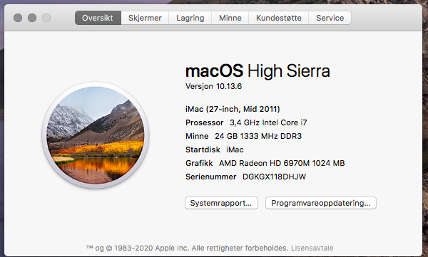

Enclosing screenshot "About". Sorry I do not know fusion drive :-( so i Guess I do not have one!
I bought the computer secondhand two years ago. So the configuration was done for me. Could the fusion drive be a fix I can do? Sounds that could be a solution. Will it work at this stage?
From what I have been able to work out this iMac was not sold with a fusion drive until I checked th model on every Mac https://everymac.com/systems/apple/...inch-aluminum-mid-2011-thunderbolt-specs.html. Also looking at the first screen shot you posted this shows the SSD as being of the brand PNY. From what I can work out the seller must have put both of these drives in the machine. More than likely the HDD has failed and need’s replacing. Ifixit have some good guides on this https://www.ifixit.com/Guide/iMac+Intel+27-Inch+EMC+2429+Hard+Drive+Replacement/7555
Another easier option would be to use an external HDD in a Thunderbolt enclosure (this may end up being more expensive though).
As to why internet recovery did not work when you try it that is due to the age of the OS. I have heard there are workarounds for this. Something to do with changing the date on the iMac when booted into the installer. Personally I would swap the internal HDD
Another quick one I would screenshot you took of about your iMac with the serial number blanked out. Real Mac serial numbers can be useful to those in the hackintosh so you shouldn’t really post them online

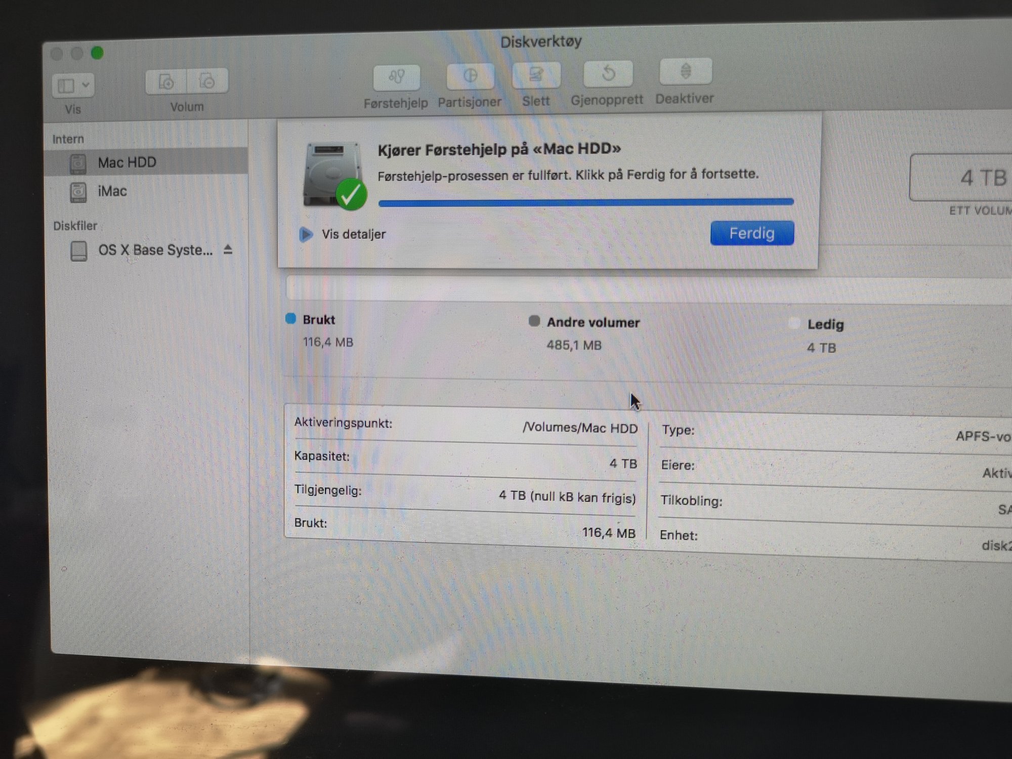

Trouble creating screenshot from First help page. Made a photo below.
This is however the result for First aid page.
First aid finished "Running First aid on "Mac HDD". First aid process completed." (With a green checkbox ticked. Seems to be ok.).
Different now is it is just only one volume. But i guess that can be adjusted if needed.
Is this ok now? Feel i it has been too easy!

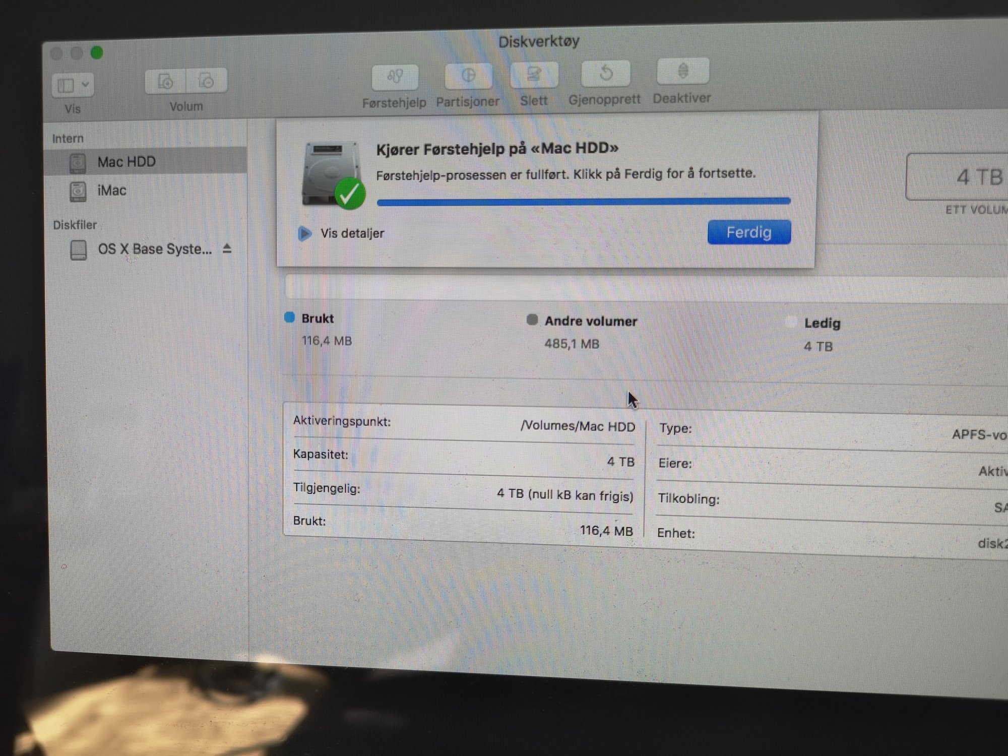

Thanks for posting this. Good learning experience, from this all I can guess is the volume was bad and not the disk. Looking at the sidebar I can still see two volumes
iMac & Mac HDD. But how you have the view preferences set you can only see the volumes at not the physical disks. I sometimes find this confusing but it is a matter of personal preference.
