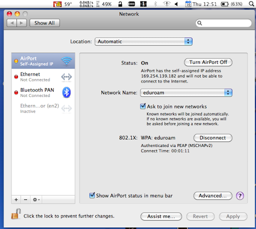

Not necessarily - it all depends on the local network is configured. If it's a self-assigned address, network preferences is going to say that the status is self-assigned and cannot connect to the internet:
If you're not getting a self-assigned message, the cable should be good - the issue is going to be with your router (mac address filtering, etc) and your mac's network settings (I know, real specific)...
