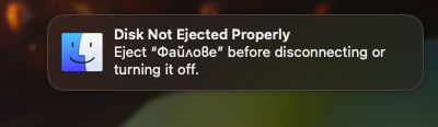

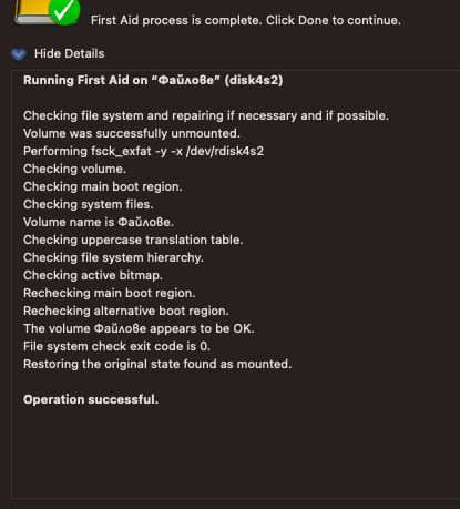

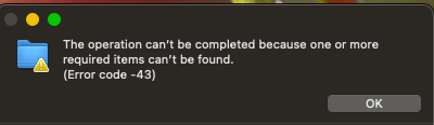

Hello! I use the Satechi hub. I added 1TB nvme m.2. But when copying a folder it suddenly gives an error and at the same time the drive is ejected. The errors it says are 2-3 types, I will show them in pictures. What could this be and is there a way to fix it? I suspect the NVME has problems, how can I check for errors the easiest way?

After install and first mount, what format did you choose for the drive? What is the brand and specs of the drive? Also, where did you purchase the drive?
I set it to exFat. this device. From an online store.
If you plan to use the hub exclusively with your Mac mini then I recommend you format the drive APFS. Disconnect all attached peripherals to the hub and try your copy tests again.
Reactions: JonnyMacx86
And that's what I did, but no difference.
Can you return it?
It is under warranty, I will try to give it to the company where I bought it for repair. It doesn't cause the problem on all the ones I copy, but on 95% it does. Selective, sometimes the same copied passes, sometimes not. I sent it in for repair. When I took it off I noticed that it was terribly hot. I don't know if it's normal.
