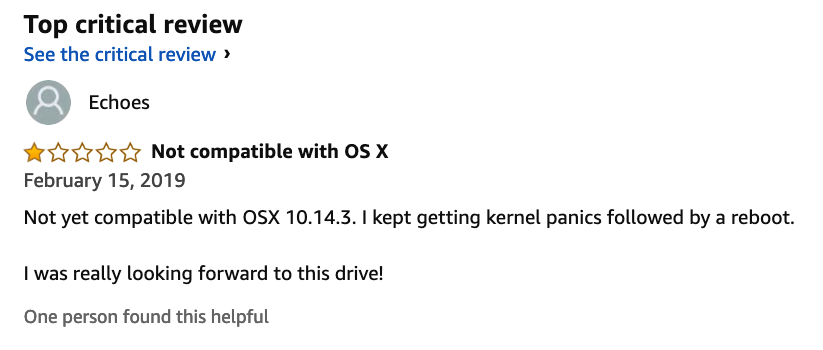

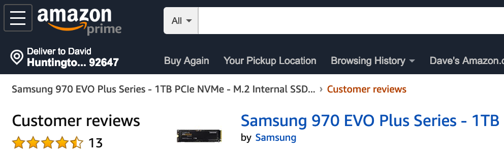

Not sure if this is of any use to you but I saw this recent review on Amazon...
Of course it's just one review on Amazon. Take with a grain of salt... =)

hackintosh users are having a difficult time with the 970 EVO+ also. I know a hackintosh isn't a "real" Mac but gives some sort of indication there could be some incompatibility between macOS and the 970 EVO+ but also sounds like most issues pop up using it as the boot drive. using it as a data drive sound like it's working as expected. check out tonymacx86 forums if you want to see more details
I tried an EVO+ today in 2 5,1 mac pros with 140.0.0.0 firmware and got formatting issues and panics followed by restarts, it did not work in high sierra or mojave
Then I sent it back and got a 970 pro. Works perfectly...

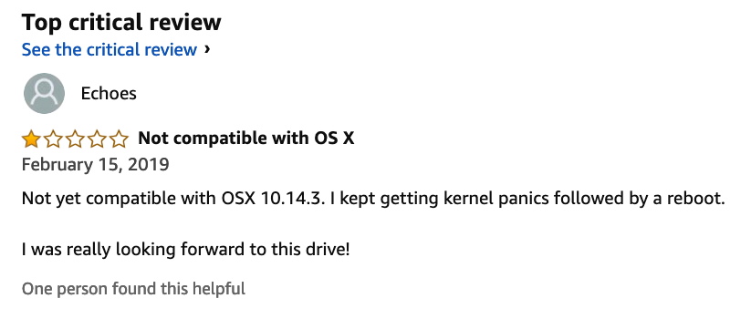

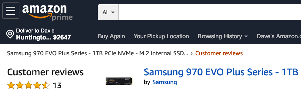

Confirmed, SAMSUNG 970 EVO+ is NOT compatible with cMPs. Personally and on the cMP Update guide blog. I believe I was on 14.2 or.3 at the time. Replaced with the older EVO, and never looked back. I have a 960 EVO as well in the SYBA switch card, getting 2.7GB/s reads. The 960 is somewhat slower, as are the write speeds. I had cheap PCI cards without the highly recommended heat sync. ($50 each with heat sync), so I sprung for the switch card which holds two M.2 NVMe blades and needs to be used in slot2 above the vid card X16. That gives me the 2.7GB/s, Normal speeds max around 1.5GB/s for cMP. I mostly did it to get both a heat sink and a small fan and save the extra PCI slot for other hardware. I'm running 14.5 with bootROM 144.0.0.0, and everything is copacetic. A friend with a monster 5,1was running High Sierra until Cap-1 got a version for Mojave. He upgraded yesterday from 13.6 with his original bootROM to Mojave 14.5 bR 144. Wish I'd done it that way. But he's not using NVMe blades yet. He has so many SATA SSDs and one pair on his SATA3 card that's in RAID0, or about 1GB/s for his boot drive. That last bR update was mostly bug fixes, and as a result, Mojave runns much smoother than earlier point updates. It looks like we are all going to be staring at those dunes til the end of time... Not looking for a new MP. I have a 12-core 3.33 with 48GB RAM, and a RX 580 with 8GB VRAM. I have five 4TB spindle in RAID5 (SoftRaid) that give me around 400MB/s which is faster than any SATA SSD in the cMPs SATA2 ports. I also have a SATA3 Sonnet card that get's just below 1GB/s. I have backup clones for both 13 and 14 just as backup, and it also gives me 800GB of fast storage. I also have a 4-core which has been updated, but with the original 2.66GHz CPU.
That should no longer be the case since Samsung released a firmware update that takes away the Kernel Panics. Typically enough I bought a 970 EVO two months ago (a little cheaper than a Plus at the time, but not much) and now I regret that I didn't hold out a little longer. 🙁
