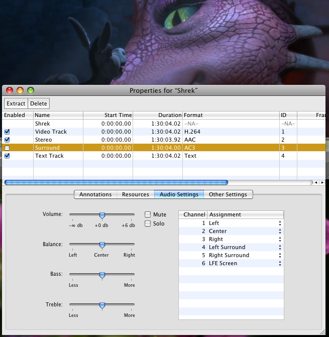

When you click on the Surround track and then the Audio Settings tab of one of these movies that's giving you trouble, do you see 6 channels, as is in the attached screen shot?

PS to Cave Man - i do see all six channels with the files in question when i go into the surround track audio settings, so handbrake is definitely not the problem. i have encodes with 5.1 it's just my apple tv isn't seeing them all properly. i wonder what's going on here...

yep that pretty much sums it up (i am using hdmi for video and audio, BTW). QT shows all 6 channels for about 5 different encodes and these play in ATV from the AAC track.
my three DD 5.1 encodes from yesterday are all playing with 5.1 so I have to chalk this up to a day of faulty 5.1 encodes I guess. Seems to be working now. It's just strange that QT sees the 5.1 on these while ATV doesn't.
