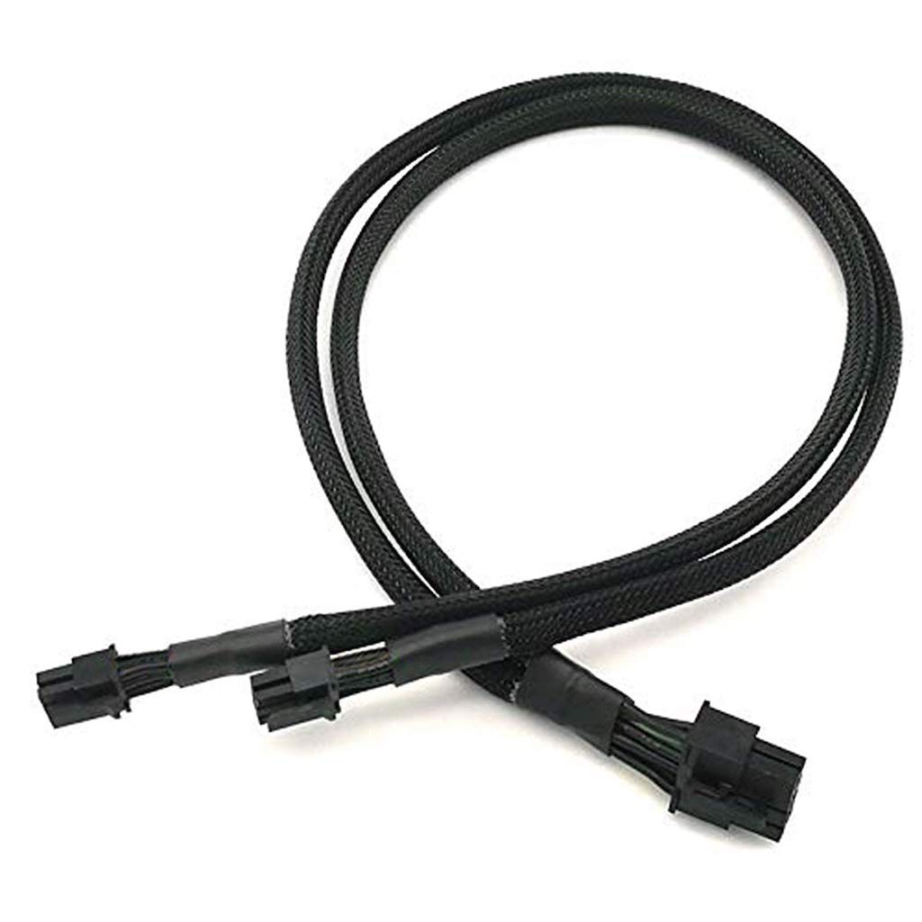

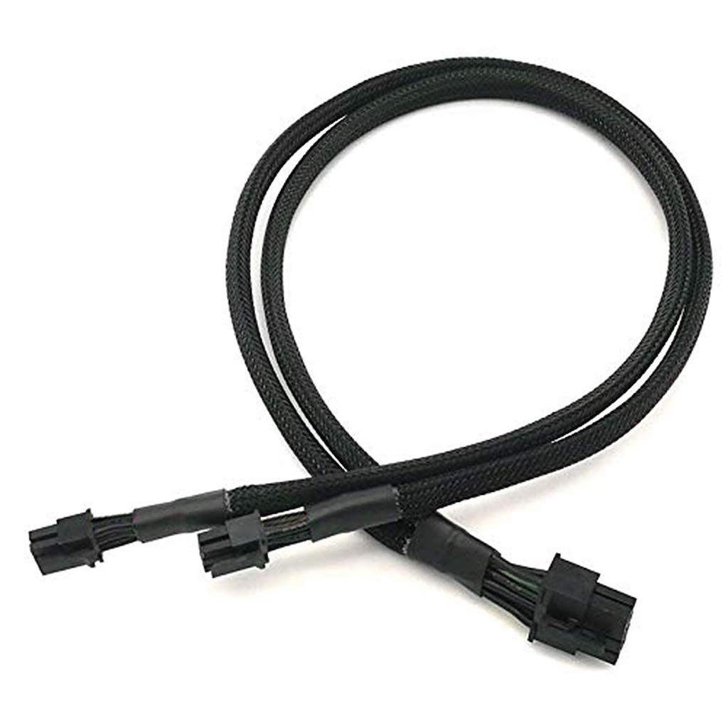

Which cable are you using for the RX 580 ?
It should be : 2 x Mini 6 pin to 1 x 8 pin
That one, I even replace it two times, but nothing changed
