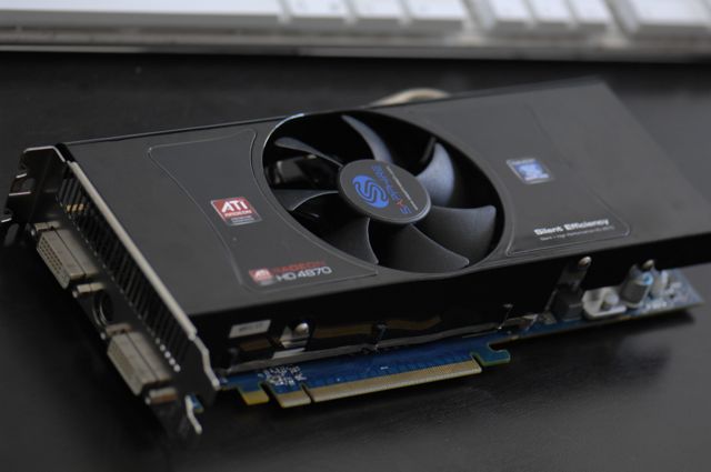

Hi. I want to flash a 4870 to replace the aging and artifacting X1900XT in my Mac Pro 1,1.
I've got a Sapphire Radeon HD4870 1GB Part Number 288-20E85-130SA
I know some people have had success installing it, and I've tracked down the ROM they used.
I've also got the cables (both tested and working). And Zeus (BTW, thanks, Cindori, you'll soon get some $ more for your efforts). And the ROM.

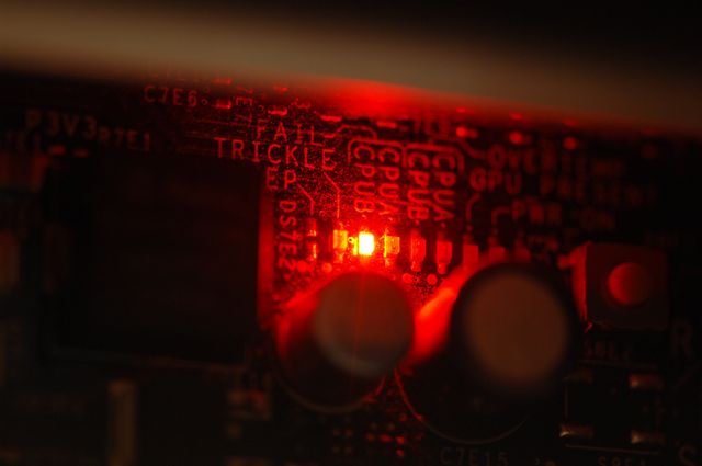

The problem comes when I put my ATI X1900XT and my new HD4870 together in the Mac Pro (each with a power cable). A red LED comes up just behind the RAM cage, and although it's half hidden by the cage, it seems to read "CPU A" or "CPU B".
When I put the 4870 alone, in the slot 1, and only the windows-dedicated hard drive, instead of booting into Windows as I'd expect it to do, well, it just doesn't boot...
How can I flash the card?
The 4870 requires two power cables.
To boot win from the 4870 you can not just keep the windows drive in, you have to boot OSX first and select Windows as startup disk. Then you can boot with onlythe 4870.
Some 4870's simply will not work to boot OSX with, even with a Mac card running the display. It will just kernel panic, hence the cpu LED
for those you will have to flash bootcd
bootcd guide is in my Golden Guide
This is what I get... with the X1900XT in Slot 1 and the HD 4870 in Slot 2, trying to boot in OS X:
The chime starts, but stops before it should
The red LED turns on.
As soon as I turn the Mac off, and take the 4870 out, everything starts working again.

I know, I've also tried with two cables, and the same thing happens. I guess I'll flash it in a PC and try again later...
How is it that other cards allow booting into windows, and this one wouldn't even go through the startup chime before the red led would go up?

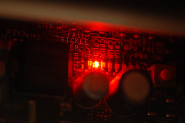

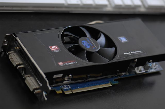

I have the same card with the same problem.
The Card won't POST in a PC either....
I can flash it using ATIflash with a PCI video card, but it still won't POST in the PC.
I think it's dead... sorry mate... 😱
Yep, it was dead... It's going back to the store. Oh well, it only means I'll have to wait more...
