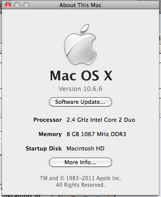

Dear friends,
I have strange, I can call it problem, or irritating thing, after I upgrade my MacBook Pro 13.3" , model 7,1 with SSD 40 GB from OWC. I replaced the original 250 GB HDD with this one, and Original one I mounted with Data Doubler from OWC, instead of DVD/CD Rom.
So, Installation went so good, I formated SSD to Mac OS Extended (Journaled), before installin from DVD ( Mac OS X 10.6.3 ), Installation went good at all. Later, I installed data doubler from OWC with original HDD shipped with Mac Book Pro ( 250 GB ), also I formatted it after installing in mac, on Mac OS Extended (Journaled).
At all, after Installing Mac OS X 10.6.3 and doing update to 10.6.6 , I have almost 25 GB Free on SSD, which is good.
Issue is, that from time to time my Mac is lag, like stopped, and after 10-15 sec I am able to move with cursor, or to switch between apps and so on. This is happening randomly.
Durring that time i see Marble of Doom ( color ball which is spinning )
Does anybody know what can be a problem, as really i was expecting just that my Mac will be faster and so on ( It is faster ofcourse, but this is so irritating ).
I attached to this post ( Info about Mac , and S-ATA ).
As You can see, in SSD is latest ver. of Firmware which OWC Published.

Firmware 343 has a lot of issues, you should contact OWC and have a 310 drive sent to you or have yours flashed to 310.

Apparently you skipped over my post...the problem is the 343 firmware.
Thanks for the Information, please can You tell me where I can download Firmware 310, as on their web they allow to download latest 🙁, which is not good. Is there any chance that I can make update from Mac OS X , or Disk Parallel on which I am running Windows XP.
Im not sure you can do it yourself, if you call them and explain your situation they may overnight a new drive with 310 to you so you have minimal downtime. I had to ship mine back to be flashed with 310 and it has worked perfectly ever since.
