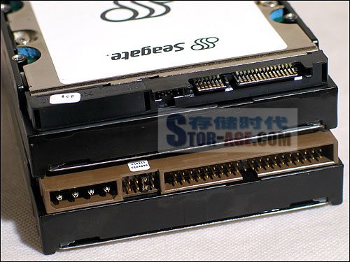

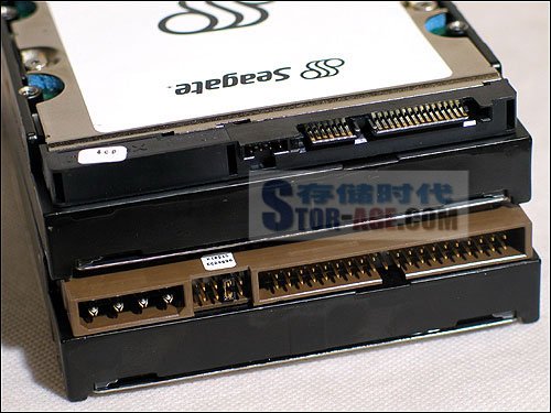

SATA is the connector on the top, and PATA/IDE is on the bottom. These are 3.5" hard drives, but the connectors look more or less the same on 2.5" drives. Not a hard mistake to make, unfortunately.
