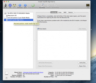

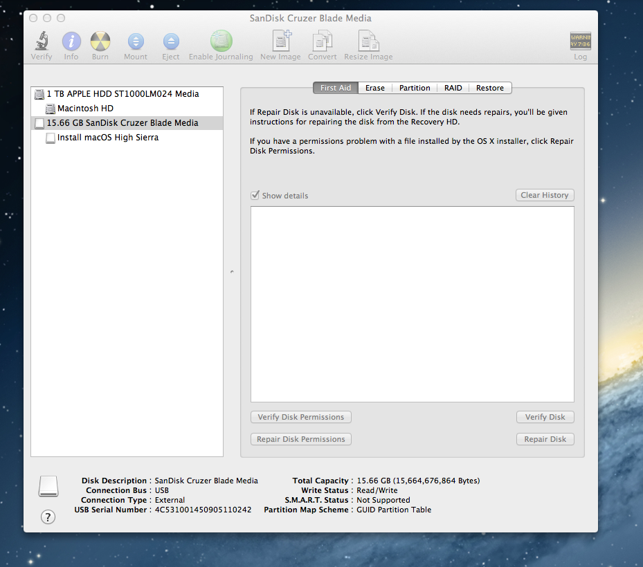

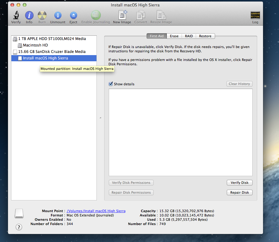

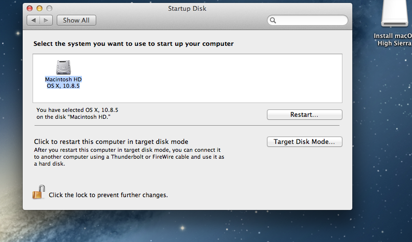

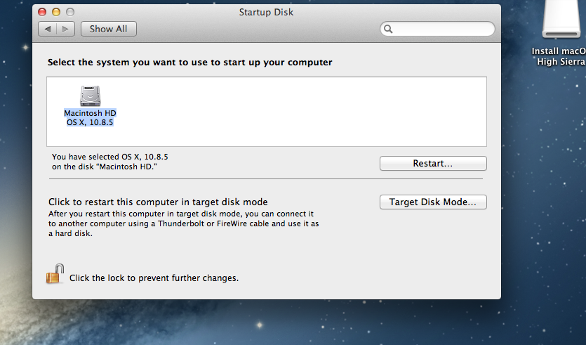

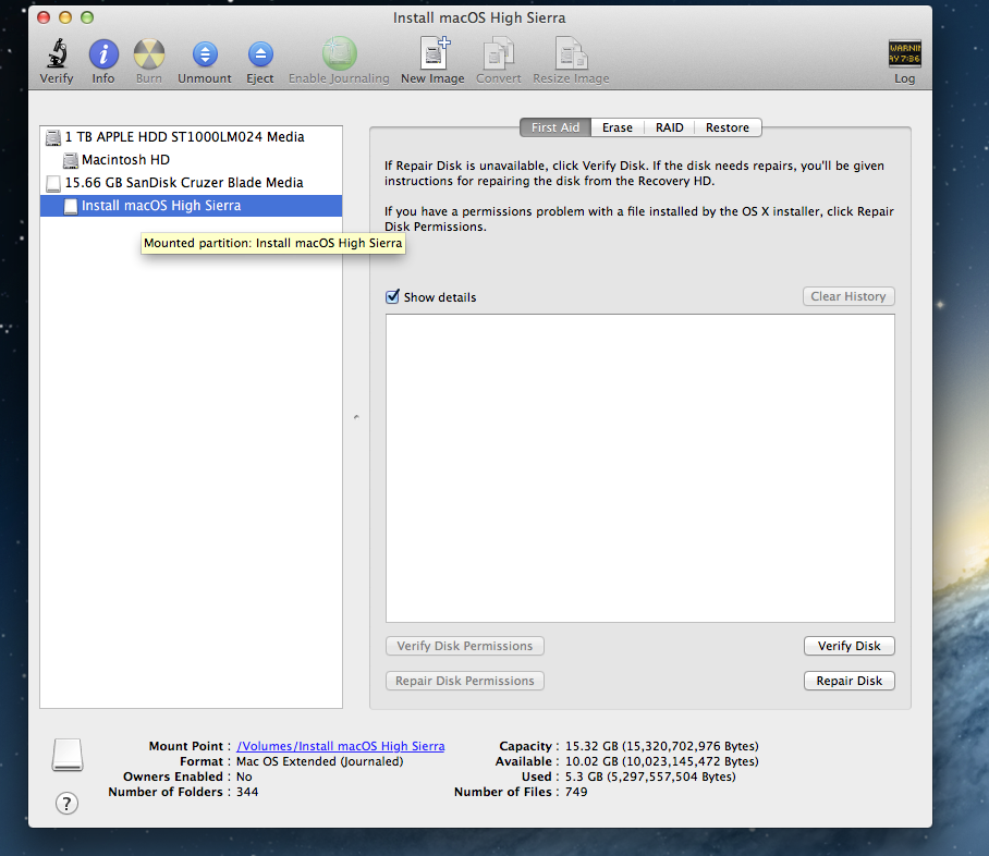

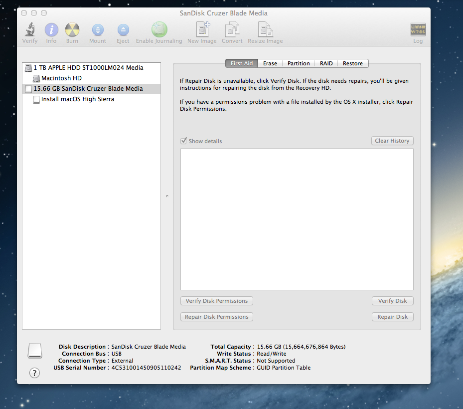

Hey thanks again. You've been so helpful--I just thought I'd throw out my latest question in case you know the answer.
Still attempting to clean up my old 2012 Mac Mini, I have gone ahead and created a USB installer for High Sierra, as suggested. However, when I go into the Disk Utility>Startup Disk in my System Preferences on the Mini (according to instructions I've found online), the USB Installer I've created doesn't show up as an option to choose from--all I get is the computer's only internal HD. The Installer does show up on the desktop and finder as normal, though.
I'm attaching screen shots of the Startup Disk app, plus the Disk Utility info on the USB Installer (both the Device and the Volume) if you or anyone has any suggestions.
Thanks again.
