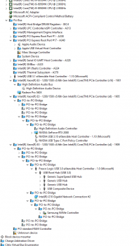

You may have resource problem. Can you check under "device manager" to see if you still have enough resources available with eGPU? Also don't use USB-C port on RTX 2070. If you don't use it, you can safely disable it along with nvidia high def audio controller to free up more resources. You can safely disable HD audio for Radeon or any PCIe controller you dont use.

Thank you for your reply!
I checked and it doesn't seem to have resource problems. I have no error triangles anywhere.

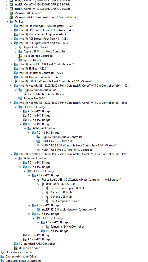

Do you boot your iMac with Razor Core X on or hot plug? It sounds like you are turning on your Razor Core X after boot. If you are turning on eGPU after boot or hot plugging it after boot, you may still have resource issue.
Can you disable unused PCIe including all NVIDIA audio and try boot with with eGPU? You are running Radeon on your PCIe x16 controller and likely running eGPU on either x4 or x8 controller. Can you try to run your external SSD and other peripherals on non-eGPU PCIe controller?
I have 2018 MacBook Pro 15 (i9-8950HK) with Windows 10 running on external Akitio TB3 NVMe, Elgato TB3 dock, Ankitio eGPU with RTX 2080. As you can see, Radeon is on x16 controller, eGPU with RTX 2080 on x4 controller, and external TB3/SSD, TB3 dock, and all USB peripherals (blu ray drive, external SSD time machine, scanner, USB DAC-amp, and etc) on x8 controller. If I don't disable some PCIe or Nvidia audio stuff, Windows 10 will occasionally rearrange resources when I plug in other USB devices (ie, iPhone and etc.). This will mess up random things until I reboot.
Unfortunately you and I have two heavy resource hogs (two video cards) and Windows can struggle with resources even with a large memory space enabled on recent Mac's firmware.
