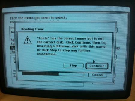

Well i have aMacintosh Classic running 6.0.7 Greek Os.Found original System 7.0 diskettes and while i was installing the system after 3rd diskette it ask me to insert the fonts diskette.Then there was an error "Fonts have the correct name but is not the correct disc"
I abort there because there was nothing else to do and now the System 7 is installed party but the most bad thing is that all systems fonts are broken and i cant read the names at folders.
Is there any solution to my problem or is there any other way to make clean install from the beginning to my lovely Macintosh Classic?

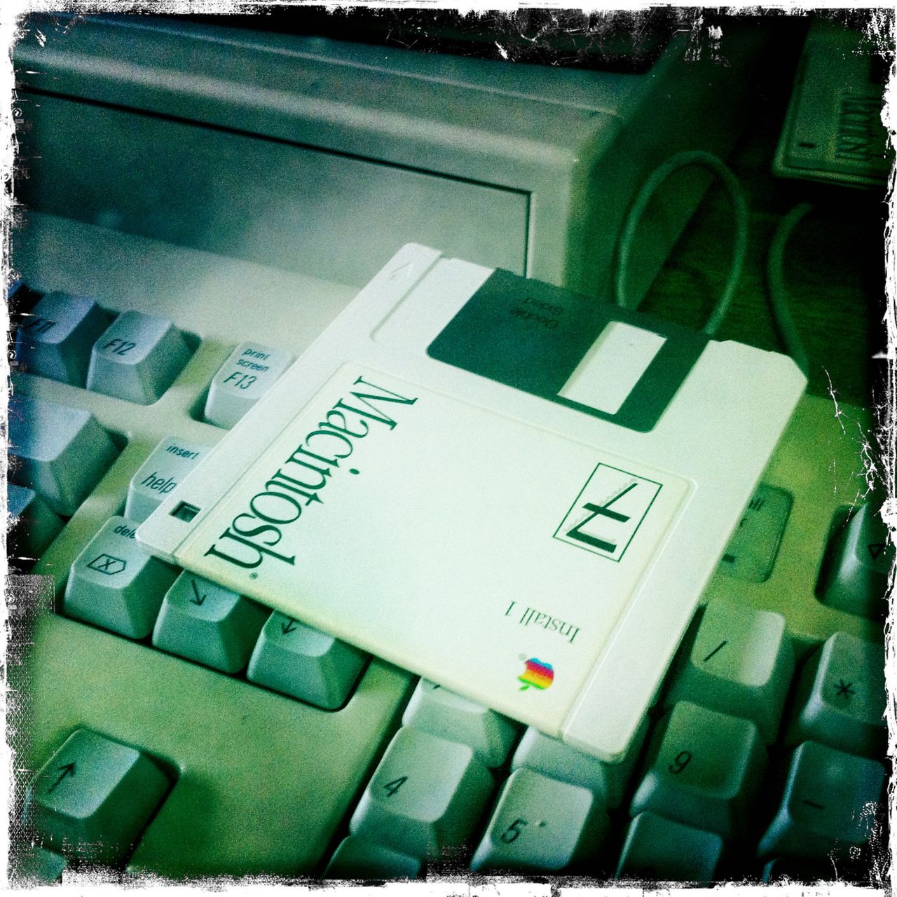

Well thank you for your reply.The discs are 690-5685-a Version 7.0 and they do have colorful apple logo.

OK, you can still get a .smi (Self Mounting Image) of a set of US 7.0 800K disks from Apple.
It might be worth looking at the disk's contents to see what's on it (or in the trash too), as you might just be able to delete files that are not part of the fonts or move a relevant file back to the disk's root directory.
You should have 11 "font suitcases", being:
Athens, Cairo, Courier, Helvetica, London, Los Angeles, Palatino, San Francisco, Symbol, Times, Venice
It's possible that somebody has taken the fonts out of their "suitcases" in which case you'll need to make a new copy of the fonts disk.
Failing that, use the link to get the 7.0 smi direct from Apple.

Incorrect. The Font Disk contains Font Suitcase files. 11 of them. If the installer is balking on the Font Disk, then either the expected files are not there or the Font Suitcases on the Font Disk have been altered. That's all - no real problem. 🙂
I seem to recall certain fonts being installed in the ROM (Chicago at least). You may be able to switch to one of them as a limp until you can make a healthy fonts disc.
