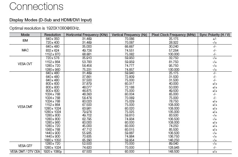

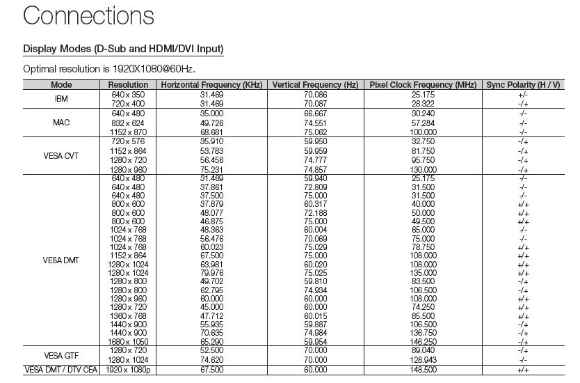

Maybe the the mini wont output a 120Hz signal, but that dosn't change the fact that the TV wont even accept a 120Hz signal anyway. This is taken out of the Samsung LN40C630 manual and lists all the modes it supports:-
Now you look through that list and tell me which mode supports a refresh rate of 120Hz..... None, so yes it's Samsungs fault. They advertise the TV as 120Hz but don't tell you it wont accept a 120Hz signal. Most people know this but the OP didn't and throught the TV would accept a 120Hz signal, therefore bad marketing.

It's not about thinking you need a 120Hz signal to take advantage of it. It's about the OP expecting to be able to input a 120Hz signal into a TV that says 120Hz on the box.
Regardless of source frequency, it's still a 120 Hz TV anyway.
Yes it's a 120Hz TV that just wont accept a 120Hz signal, which is what it seems the OP expected it to be able to do. You've got to see how it could be confusing to some people.
