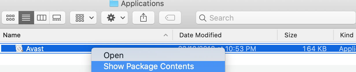

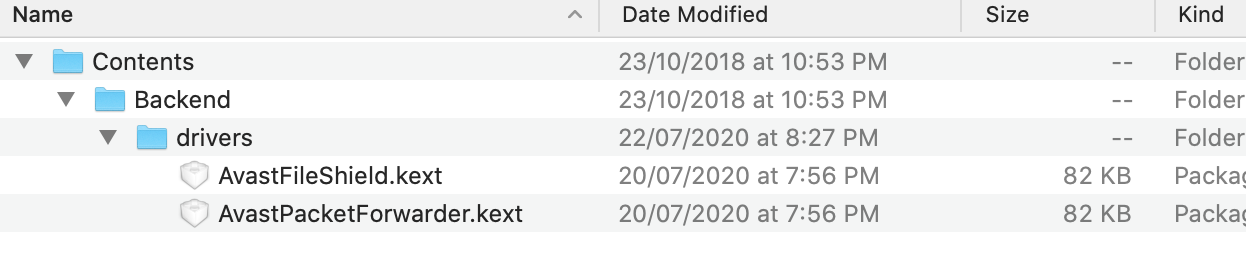

Hi xlii! As I was in the same situation as joshlikesbagels I did as you said and typed rm -r then I dragged the file that I wanted to delete into it, pressed enter and got this back
override rw-r--r-- root/wheel restricted for /Library/StagedExtensions/Applications/Avast.app/Contents/Backend/drivers/AvastPacketForwarder.kext/Contents/_CodeSignature/CodeResources?
to which I typed y and entered to get
rm: /Library/StagedExtensions/Applications/Avast.app/Contents/Backend/drivers/AvastPacketForwarder.kext/Contents/_CodeSignature/CodeResources: Operation not permitted
Would you have any advice for me? I am currently very lost...Thank you in advance!
P.s I don't know if its related but my app seems to have a few other folders in it
