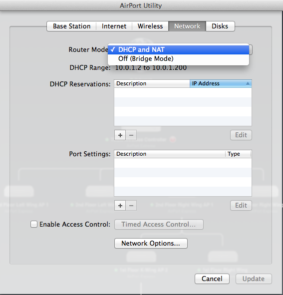

Try switching from Bridge Mode to DHCP And NAT mode. It will throw a double NAT error but see if the issue is temporarily resolved. It should be.
Then set the modem to bridge mode. Most modems have a series of options to make that work. Otherwise, if this is ISP supplied equipment, calling the ISP will make them do it for you. Then just reboot everything and get back to gaming.
NOTE: Try to avoid leaving the router in a "Double NAT" configuration. It can cause headaches later, increases latency, and all ports must be forwarded twice.

Check my screen shot out. It will cause the AirPort to give a warning of Double NAT. Do not leave it like this though.
